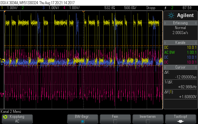

I'm using the LMX2571 for 4-FSK modulation (GFSK via oversampling, I2S mode). I wanted to optimize PLL settings to get a better eye diagram. The symbol change has (i guess) an overshoot which I wanted to get rid of. But at the moment the demodulated signal is to much disturbed, I can't even control an eye-diagram. When I started to evaluate it was much better. I also was able to produce a sinusoidal FM modulation.

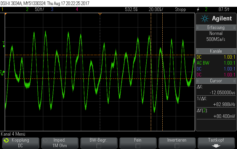

Looking now on a random GFSK signal it looks just like noise. That's why I'm showing you a change from FSK symbol 00 to 11 with oversampling, should be sinusoidal. But at the moment...well, take a look (markers are just somewhere, don't mean anything):
Averaging the signal, it is sinusoidal.

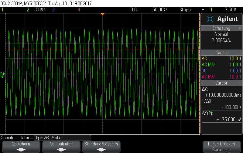

The following screenshot was taken in the past, much better but already a little bit disturbed. I think it was even better, but I don't have a screenshot of this "far away past".
I thought about corrupted I2S data, controlling huge arrays of data send to the LMX, but it looks all fine. It is repeating periodically, constant output. But it looks like the LMX sends the wrong deviations from time to time. Using a slower I2S data rate, increasing the baud rate, the disturbance get's even bigger, looking at the demodulated signal. But maybe it just stays equal high, looking only on the time domain. (markers show one periode, changing from symbol 11, 00, 11)

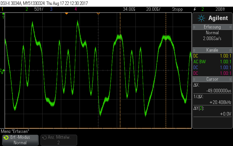

I played with the deviation, using lower deviation levels.

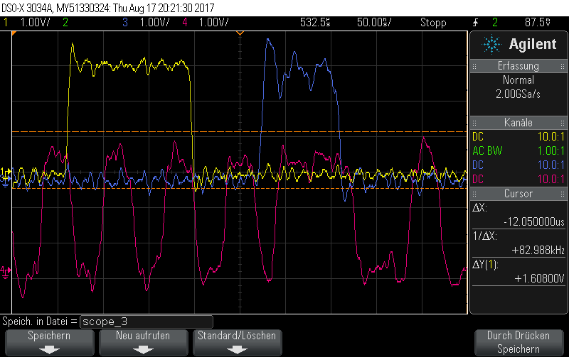

Here a screenshot of the I2S signal (red: CLK; blue: FS; yellow: DATA).
Detail of FS. If I had measured a bit better, it would have been more rectangular...

    I thought about corrupted I2S data all the time. It was pure coincidence that I saw the FS cable solder joint was nearly broken. So the LMX sometimes got the signal, but most time the input data was useless....
