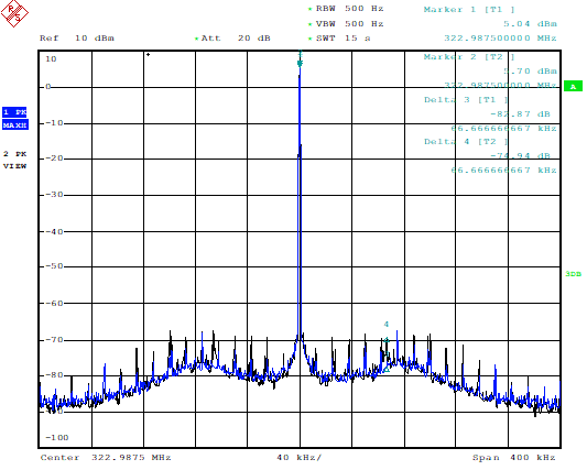

we try to improve the SNR of a LMX2581 using the differential outputs. The used carrier frequencies for this project are about 70 MHz and 323 MHz with a digital PWR setting from 5 to 30.
In the attachment you will find a picture of the measured SNR. I applied 30nH inductors -> Z about 50ohms (2*pi*f*L) with OUTx_PWR = 30 and Freq.=322.9875MHZ at this setting. Result: SNR=68.16 dB.
In a previous test I already applied a Balun after the pull-ups but this hadn´t any relevant effect on the SNR. With inductive matching the result was even a bit worse than without Balun.

    1) The SNR you are referring to is perhaps more a spurious free range or some spectral purity. TYpically the SNR would imply some integration over a certain amount of BW. Your application should dictate that.
    2) Getting the most output power may help but spurious response may scale 1:1. I would use the guidance of the datasheet for pull up components. 50 ohm is a good place to start. You may look elsewhere for spectral purity.
    3) I noticed that the "grass" you have on your spectrum analyzer is spaced by about 15 kHz which is about a sync frequency on a CRT diaplay. Could this be the root cause of these spur?
    4) How are you generating 322.9875MHz from LMX2581? are you in frac mode? if you are you will need to study the possible fractional spur you may generate and how to minimize them. Operating in integer mode would be interesting if you do not have frequency step required.

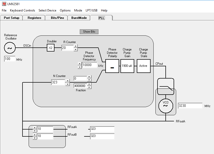

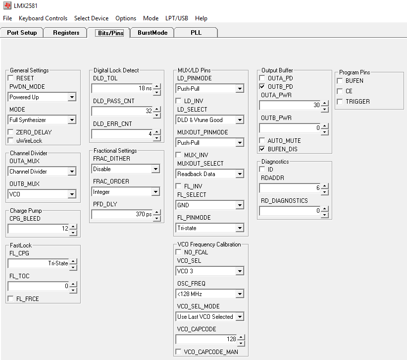

    I am a bit confused about the signal when PLL_Num = 0.
    Why is the Noise, close to the carrier frequency, so high? Can someone explain that phenomenon to me? Please tell me how to use the integer mode correctly. I thought when I enable integer mode and set the fractional numerator to zero I get better phase noise and spurs?!
    In the attachment you will find a screenshot of the Code Loader settings and the signal with PLL_Num = 0.
    Thanks in advance,
     Adrian
  • Hi Adrian,
    Could you try make R-counter to 1 and charge pump gain to 220µA?
    You may also try put CPG_BLEED to 0.
  • Hello Noel,
    Thanks for your advice. I attached the results of your settings plus I experimented with some other settings, higher VCO frequency, modulator order etc. The current setting seems to be the best. Unfortunately, there are still spurs in the signal as you can see…
    Tell me if I am wrong, but I can´t use the integer mode when PLL_Num isn’t zero?! It seems that the signal is the best when the R-counter is 1 as you mentioned. The problem is, that this restriction does not allow to use integer mode.
    Ok, integer mode isn’t compatible for every frequency because PLL_Num has to be zero. But with this further restriction, integer mode would be useless when the remaining parameters will fit for only a few frequencies?!
    Adrian
  • Hi Adrian,
    I am a bit confused, are you looking for 323MHz or 322.9875MHz?
    323MHz is an integer channel, NUM is equal to 0, the setting of fractional order is not matter, you should get clean signal even if you use 3rd order.
    322.9875MHz is a fractional channel, there will be some fractional spurs. If you change the configuration a little bit, you can push these spurs away from the carrier and as a result the spurs levels are reduced.

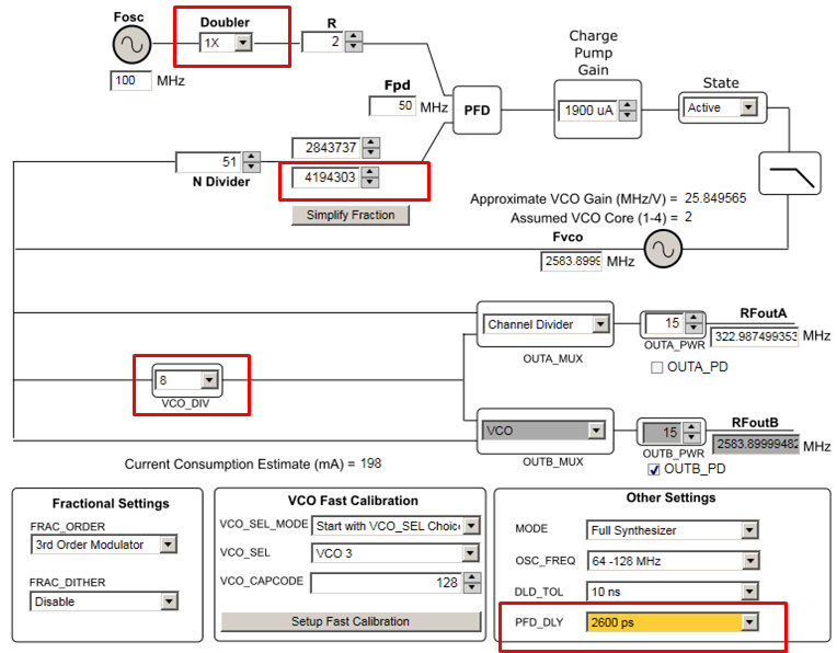

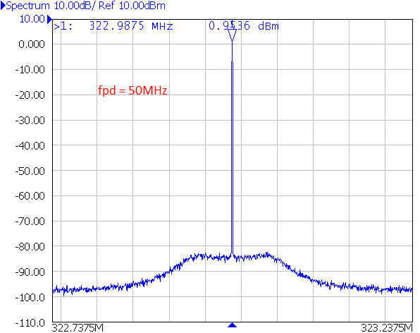

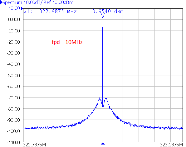

    With OSCin freq = 100MHz, I don't think we need doubler anymore. Change the fractional denominator to the max. value. Use div/8 to change the VCO frequency. This way, the spurs frequency will be pushed away from the carrier. Change PFD_DLY to make the phase noise looks better.
    Here is the test result with fpd = 10MHz and 50MHz.
  • Sorry, the first plot should be this one.
  • Hi Noel,
    thank you for your detailed answer. The test result with fpd=50MHz looks pretty good. I will try these parameters in my application.
    Sorry, I forgot to mention that i use 323 and 322.9875 MHz. I also use other frequencies. The range is between 200 and 400 MHz.
    For feasibility analysis I tried to get the best setting for single frequencies. I chose 323 MHz because integer and fractional mode was possible. 322.9875 MHz is a typical used channel in our applications. As you already mentioned this is a fractional channel. Because every channel must have similar SNR and Spurs i have to use the fractional mode for every frequency but I had to check if integer is much better than fractional mode (of course only for suitable frequencies).
    i will post my results after my next measurement
