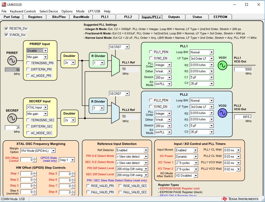

  • Hello Tim,
    Thanks for the information.
    Please clarify below points:
    1) Whether there will be any performance issues if I use a 25Mhz crystal ( as given in below image) ?
    2) For another K2H soc, I need only 7 clock inputs. Instead of two 312.5Mhz, only one is used. Whether can i use same configuration by keeping out1 as unused? or Is it better to swap 122.88Mhz and 312.5Mhz so that out7 will remain unused?
    3) How to terminate unused outputs? whether connecting a 100E resisotr between P and N pins would be okay?
    Thanks & Regards,
    Madhu
  • Hi Madhu,
    1. The jitter will slightly increase since the phase detector is running slower, however it should still be able to clock the K2H fine. See attached file: I modified the example config file to use a 25MHz crystal. You can refer to this file since the settings are already optimized.
    2. It is fine to use the same configuration and just terminate the output you are not using.
    3. Yes, for LVDS, unused outputs should either be disabled or terminated with 100 ohms between P and N.
    -TimLMK03328 K2H Example 2.zip
  • Hi Tim,
    In the above configuration suggested, PLL1 output will be 5000MHz and PLL2 output will be 4915.2MHz.
    As of my understanding, PLL1 will be integer mode and PLL2 in fractional mode. So LF1 capacitor must be 3300pF and LF2 capacitor must be  0.033uF.
    Please correct if I am wrong.
    Madhu
  • Hi Madhu,
    That is correct.
    -Tim
