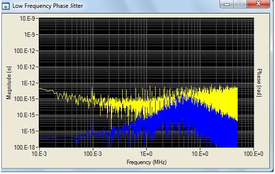

My customer met a problem when testing the clock phase jitter.
Just like below figure, the test item is failed.
This clock is the source of BMC (PCIe gen2.)
Now they are trying to modify the damping resistor on LMK00338RTAR. Chang from 33ohm to 22 ohm.
But we still want to ask you have you ever seen this kind of issue?
Could we solve it by modifying the code of LMK00338RTAR?
Thank you.
  • Can they share the screenshot showing the Clock Jitter Test Results window (e.g. Pass/Fail, High Frequency Jitter values, Low Frequency Jitter values)?
    Can they share the o-scope setup file?  The measurement result is very dependent to the o-scope settings.
    They should follow the following o-scope setup guidelines:
    •Real time acquisition, no interpolation
    •Minimum 160 uS/division(200 uS/division)
    •Minimum 12.5 Gs/s sample rate(25 Gs/s)
    •Vertical scale set to maximum 100 mV/div (50 mV/div can give better results)
    •4 GHz bandwidth
    •Capture Rising Edge
    Make sure they set the proper measurement reference point.  The most consistent reference is at the fastest part of the edge, which may deviate from the 50% level or zero-crossing point.
    Can they send a screenshot of the single-ended (P & N) and differential (P-N) waveforms?  Keep probe tip wires as short as possible to minimize reflections.
