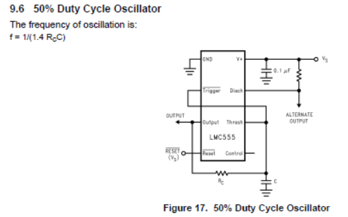

1, The following schematic shows freq = 25KHz, How to calculate?
2, How to generate freq = 21.5KHz wave? Just change R2?
3, The Pin 7 (DISCH) is square wave output pin?
  • Dong,
    1)  The diodes and potentiometer complicate the formula based on R3 and C2 values.
    2) No, change R3 or better yet, C2
    3) Yes it is. Pin 7 sinks current and R2 is pull up resistor for VOH.
    I suggest using  50% example from LMC555 data sheet.
    Rc = 100k, C = 330pF
