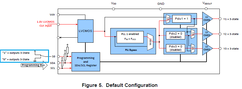

Hi Team,
It seems all outputs (Y1/Y2/Y3) are set to 3-state output regardless of S0 pin is High or Low in default configuration.
Is it correct?

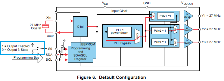

Regarding CDCE913, I found all outputs (Y1/Y2/Y3) are enabled when S0 pin is High in default configuration.
