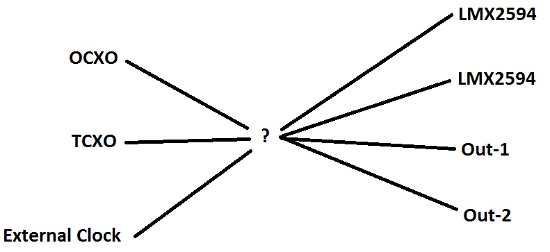

Hi, I am having hard time about choosing a right topology for my design .
I have three reference clock which I want to choose one at a time for my PLL's(LMX2594) reference clock.
- One clock reference is OCXO on my PCB for low phase noise
- One clock reference is TCXO on my PCB
- And the other is external clock.
The problem is TCXOs can't drive 50ohm loads,(at least the ones I have searched. Could you please suggest me a one if you know). So I started searching fanout-buffers. However, they require high slew rates like LMK00304 and my OCXO's and TCXO's output slew rate is about 3V/5ns.
Could you please suggest me a solution for this problem ? What is the best buffer with lowest additive jitter and requires lower input slew rates ? Or  is there a better solution than using fanout buffers? LMK01000 is the best one I could find .
Also I couldn't find any information about minimum required slew rate of LMX2594 reference clock.
  • Hi Frederich,
    What are the frequencies and amplitudes of all the reference clocks? And what is the format of the external clock?
  • Thanks for the answer, the format of the external clock is unimportant since I can set it to whatever I want. All of the reference clocks' frequencies is 100MHz. OCXO has a LVCMOS output(High Voltage is 3V) and TCXO has a LVDS output with 350mV differential voltage. However I can change them If there is a better solution. I couldn't find any TCXO with low slew rate and high output power.

  • Hi Frederich,
    As input signal slew rate will affect the noise floor of the buffer. From the datasheet, the noise floor of LMK01000 LVPECL output is -158dBc/Hz. Assume the noise floor degrades to -155dBc/Hz with input signal having 0.5V/ns slew rate. With your TCXO as the input clock, then the output phase noise of the buffer at 5MHz offset will become -152dBc/Hz. However, if the loop bandwidth of LMX2594 is <<5MHz, then this increment in phase noise is not important.
    LMX2594 cares the phase noise of the reference signal at offset below the loop bandwidth. If the loop bandwidth is 200kHz, then the phase noises of the reference signal at offset below 200kHz are important. If you add the noise floor of the buffer to the TCXO phase noise, at offset below 200kHz, the output phase noises are pretty much the same as the TCXO. So the "additive jitter" of the buffer is actually not important here.
    I would say the slew rate of the TCXO and the noise floor of the buffer are not important here. The phase noise of the TCXO is a concern. In LMX2594EVM user's guide, we have the following description. It is expected that the in-band phase noise of LMX2594 is not going to be optimized with your TCXO.
