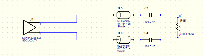

I am helping customer to simulate the SI of SDCLKout waveform with LVDS output format for a signal output at 122.88MHz.
 I have done two tests:

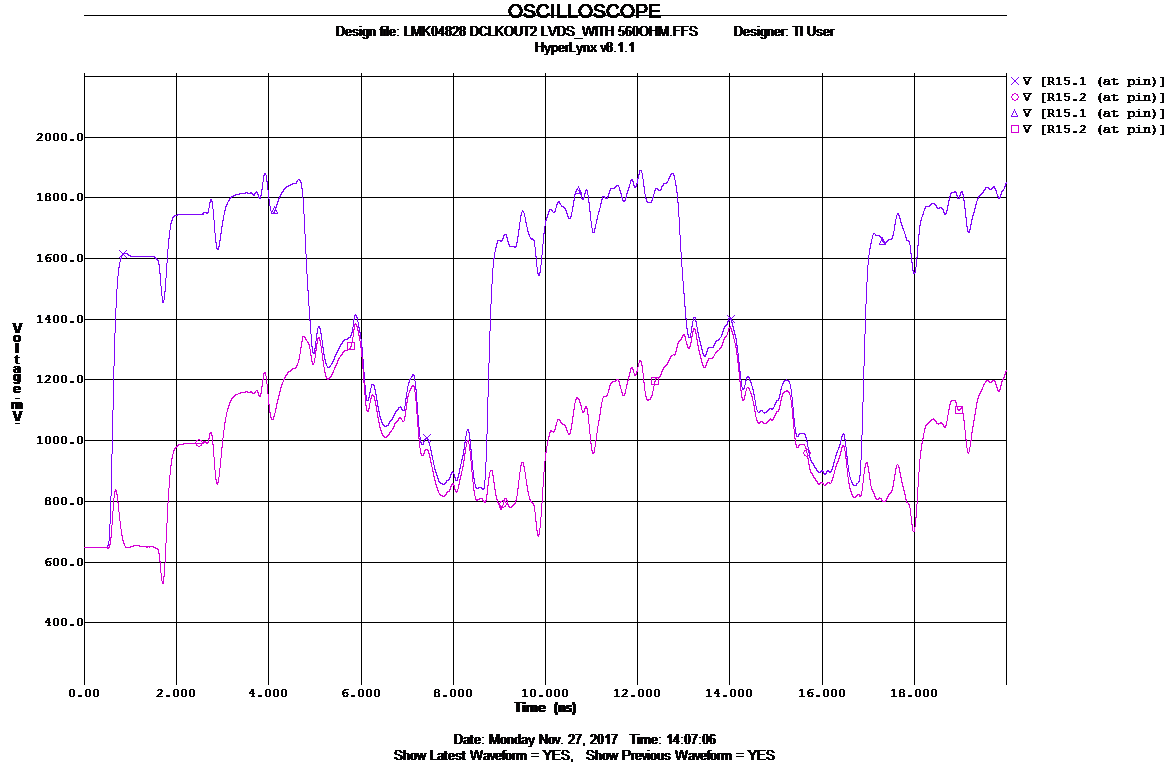

1. First one, I connect 100nF ac coupling cap between LMK04828 SDCLKout output and differential100 Ohm termination. I found the waveform at the two ends of 100 Ohm load resistor is wired as below:

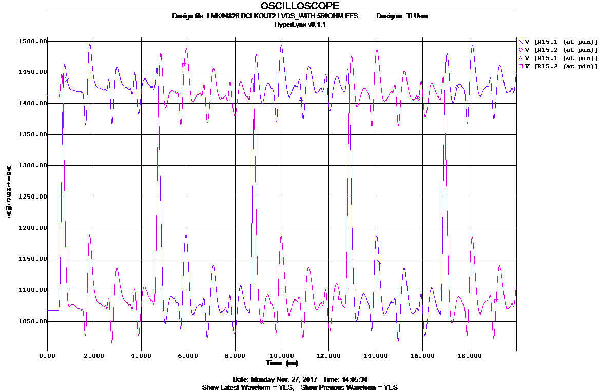

2. The second, I remove the AC coupling caps and do the simualtion again. I found the waveform is more reasonable which has common mode of 1.2V, while it shows a lot of ringing. Do you think this is correct?
May I know why I need to remove the AC coupling cap between the transimitter and load? Could you please help me to check whether the simulation in my second test is correct? I don't know why there is a lot of ringing.

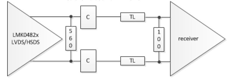

  • Hello Yarn,
    If you want to ac couple the LVDS outputs directly, please put a 560 ohm resister between P/N output like shown below. The LVDS stages in LMK0482x needs a dc path before ac coupling.
    Best regards

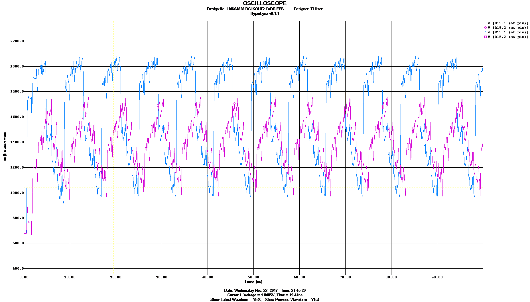

    Thanks for your prompt reply.
    By adding the 560 Ohm DC biasing resistor before ac coupling, I still found the same problem, while removing the cap still help.
    Can you please double check with my simulation as below?
    1. Test1: add 560 Ohm for DC biasing at the output of LMK04828
    2. Test2: removing the AC cap still helps the simulation

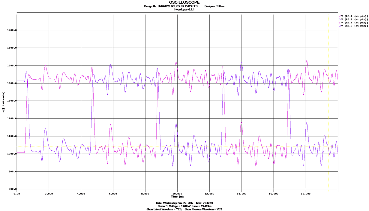

    Thank you so much for your time to look at this.

  • Hi Yarn,
    Sorry for the late reply. I tried to simulate that and i see the same with the ac coupling. I think it is a convergence issue with the IBIS model. When you attach weak dc biasing to the capacitors and it is working fine. I will have to forward this to the IBIS modelling team.
    Best regards
