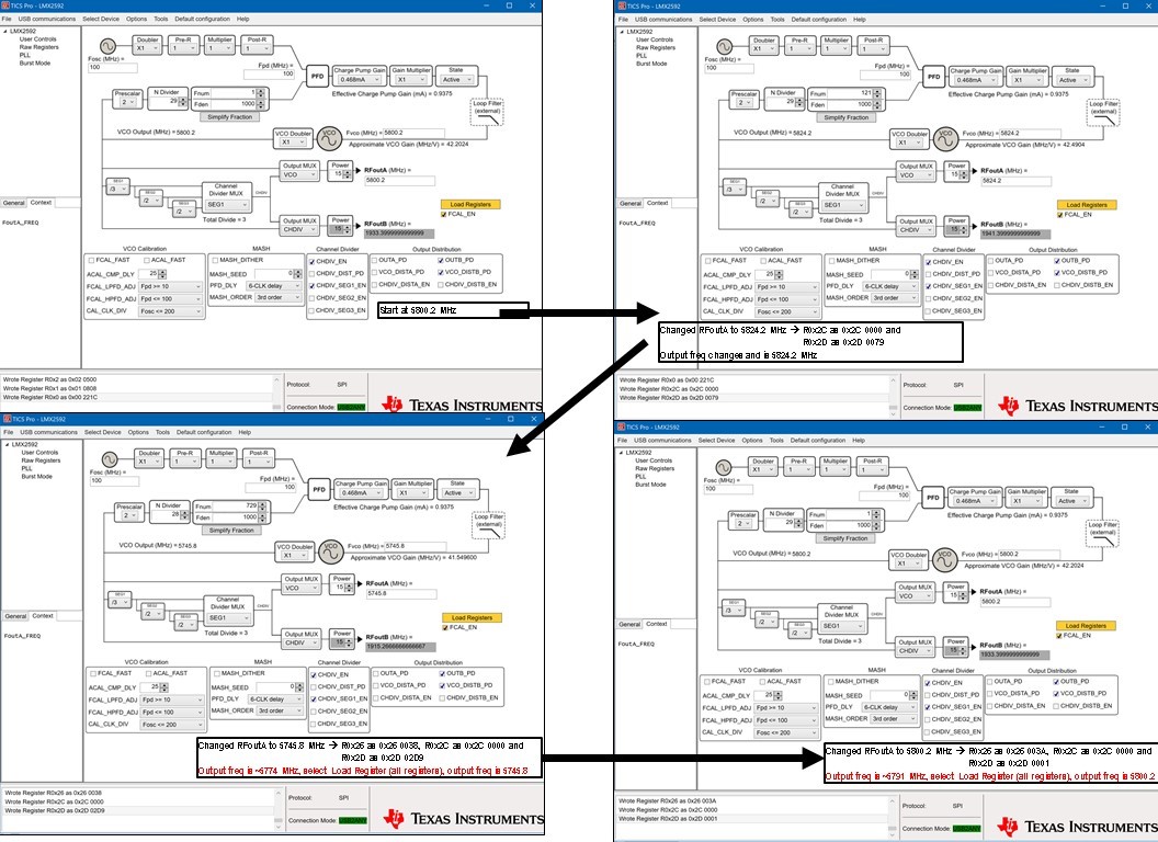

    What frequency do you want to change from 5800MHz? Could you provide a screen shot of TICS Pro?
    Are you having problem programming the device with the MCU but not with USB2ANY?
  • Hi Noel,
    Correct; I am able to successfully change frequencies with USB2ANY/TICS Pro but not with the MCU.  I have attached a screenshot collage of all TICS Pro frequency changes.
    For the first change, I am trying to change from 5800.2 MHz to 5824.2 MHz and then to 5745.8 MHz, so the only register values that change are R38 (when changing between 57xx and 58xx) and R45.  The range of frequencies I am using is between 5725 MHz and 5850 MHz (implementing frequency hopping), so I will need to change both R45 and R38 if going from 58xx MHz to 57xx MHz.  The PLL denominator (R40 and R41) never changes for my hopset.  Even though R44 never changes (always 0 for the range of frequencies in my hopset), I am still writing 0s to the register since that is a step that TICS Pro performs.  I also have the MCU writing the registers in the same order as TICS Pro (Step 2 just says R45 and R44; TICS Pro specifically changes R44 first then R45).
    While troubleshooting with the USB2ANY, I noticed another issue while changing frequencies with TICS Pro.  Changes from 58xx to 58xx MHz only require a change to the RFoutA field and the output frequency is correct.  Any changes from 58xx to 57xx or 57xx to 58xx will not output the correct frequency until I load all registers (see red text in attached screenshots).

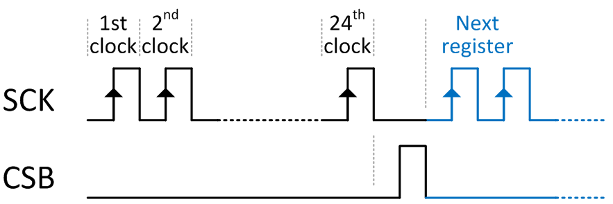

  • Hi Rob,
    A CSB (latch enable) signal is required between each register write. Make sure your code generates similar waveform as below. Right after R0 is programmed, the VCO will calibrate and then followed by analog loop locking. Both of these actions take time. VCO calibration time is around 100us, depending on the configuration. Analog lock time depends on your loop bandwidth. So you should wait sufficient amount of time for the loop to lock to the new frequency before changing the frequency again.
