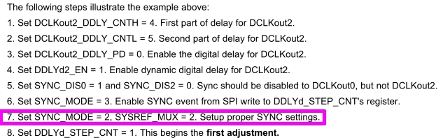

LMK04828: SYNC_MODE in section 9.3.3.3 Dynamic Digital Delay Example (as shown below)
Part Number: LMK04828
Question 1:
I don't understand step 7 in this example.  It seems like it sets the SYNC_MODE back to 2 after previously setting it to 3 in step 6.  Elsewhere in the document it says that SYNC_MODE must be 3 to generate a SYNC event when writing the DDLYd_STEP_CNT  register.  Is there perhaps a typo in step 7?
Question 2:
The documentation also says that the ONLY way to use dynamic delay is with writing the DDLYd_STEP_CNT  register via SPI.  Just to verify, you can NOT use the external SYNC input to execute the number of delay insertions currently specified in DDLYd_STEP_CNT ?  It would make my design easier if I could use an edge mode SYNC input to insert DDLYd_STEP_CNT  delays with each edge of the SYNC input.
Chris
  • Hello Chris
    Please see my comments below:
    Question 1:
    A: SYNC_MODE should be kept 3 in step 7.
    Question 2:
    A: The dynamic digital delays can only be applied using write to DDLYd_STEP_CNT.
    Best regards
    Puneet
