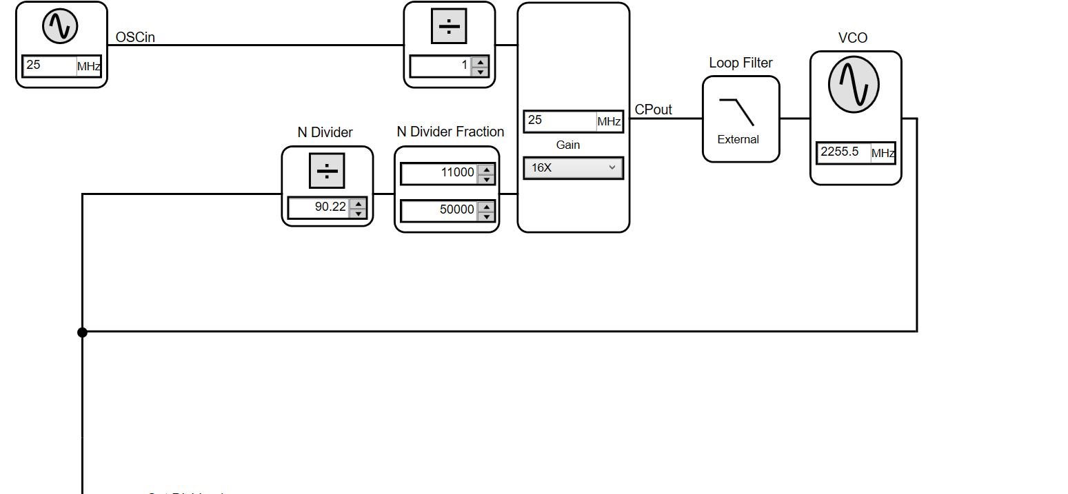

I am using LMX2531LQ2265E EVM to generate 2255.5MHz from 25MHz clock reference. I have fed 3V Vcc to EVM. I feeding 25MHz@8dBm sinewave ref clock from Agilent signal generator.
This EVM has to draw around 40-50mA current. But when I switch on power supply, EVM is not drawing any current form 3V Vcc.
Then I tried to program the device using code-loader, But device is not at all responding. I also tried using Tics-pro. But same problem occurred.
I measured Voltage on EVM, they are correct. CE is 2V(once I load register from code-loader). But I am not geeting any output from EVM.
I using internal Loop filter. And my registers setting are as below.
R5 (INIT1) 0x840005
R5 (INIT2) 0x800005
R5 0x8007F5
R12 0x01048C
R9 0x000BA9
R8 0x028008
R7 0x019207
R6 0x168006
R4 0x3C0004
R3 0x6CC0C3
R2 0x4D4012
R1 0x3E0021
R0 0x5AAF80
