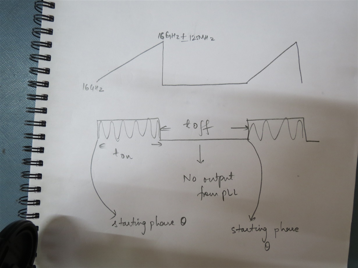

I want to use LMX2595 in the chirp mode with variable pulse width ie on time and off time for the chirp will change in system. As per the datasheet, when the chirp generation is over, it comes back to first frequency. Is there any method to switch off th frequency generation in this mode without switching off the PLL as settling time will come into picture. For the same pulse operation, if I start the chirp once again, how to make the phase coherency pulse to pulse.
