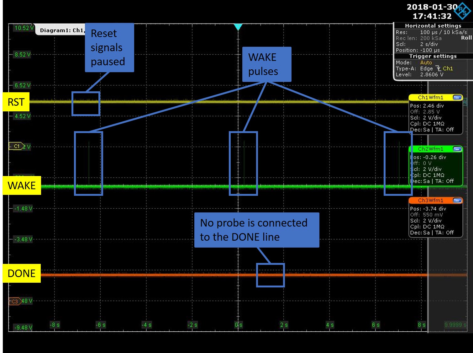

We're developing a product that uses tpl5010 as a watchdog timer. I handed bare PCBs to the software team to develop the code.
After a while they complained that sometimes the reset signal is not being issued by TPL5010 at all.

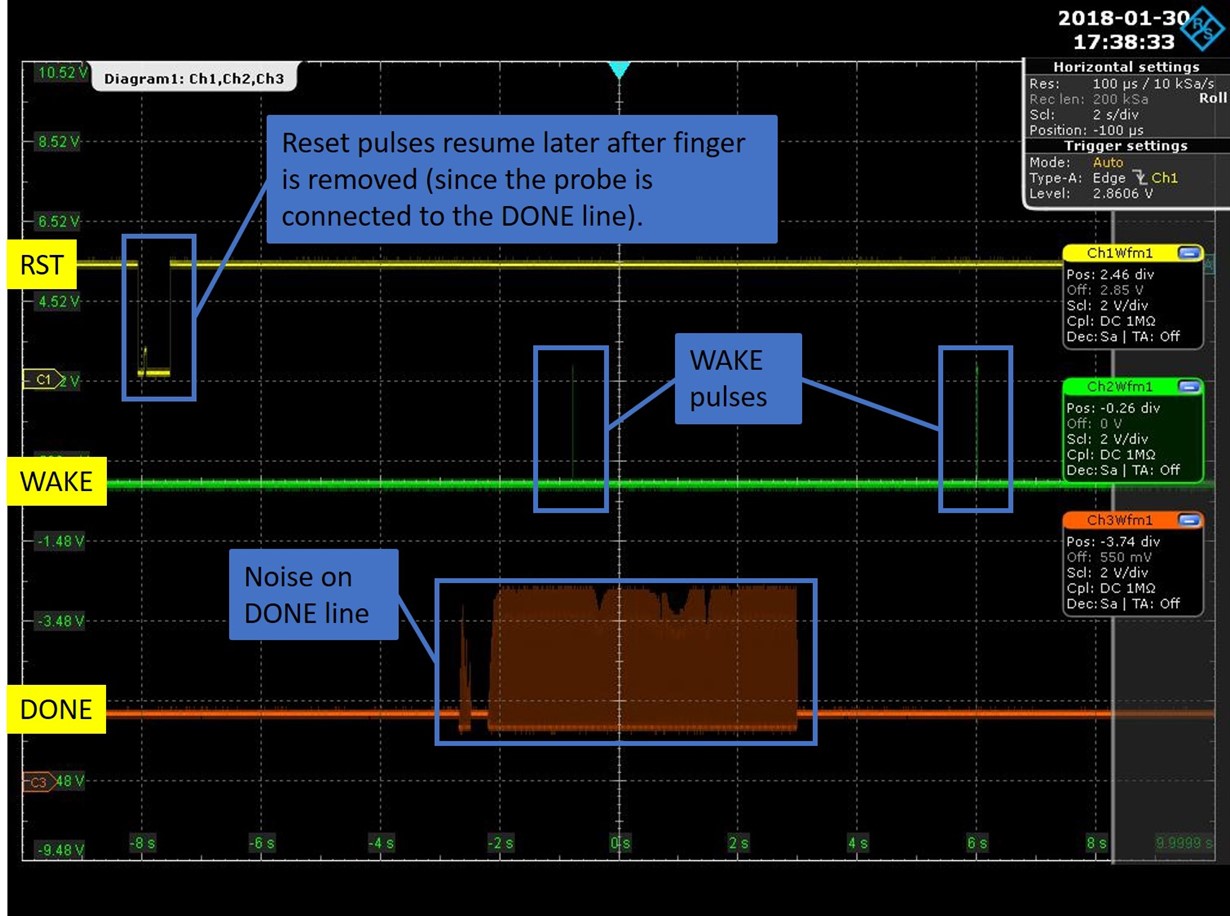

I further checked, and noticed that this specifically happens when a connector that goes to the DONE pin is touched by hand. The problem happens more consistently if both the WAKE and DONE pin connectors are touched by hand at the same time. Touching the WAKE pin connector only does not cause the issue.
It appeared that the human body couples the 60Hz from the wal to the DONE pin connector. Taken from the oscilloscope this is the trace on the DONE connector when touched by a finger (notice the considerable amplitude of >2V):

  • Hi Lane,
    Thank you for your reply.
    I resolved the issue. But not sure if my explanation of the solution is valid.
    When oscilloscope probe is NOT connected to DONE:
    The DONE pin was floating in my test setup. When I touched it with my finger, it apparently accumulated some charge and continued to pick the noise. This caused the TPL5010 to keep thinking it is receiving DONE signals for some reason, and it never recovered. It kept sending a trail of WAKE signals.
    When oscilloscope probe is connected to DONE:
    When I connected the oscilloscope probe to the DONE connector, and touched it with my finger, the TPL5010 acknowledged the noise as a DONE signal but was able to recover. Apparently the 1MOhm resistance to ground on the oscilloscope input drained any accumulated charge and pulled the line down. You can see the noise caused by a finger touch on the DONE line.
    Is there a requirement on the DONE and WAKE lines to be pulled down by the microcontroller's GPIO? Do you think the above explanation is valid?
    Thank you!
