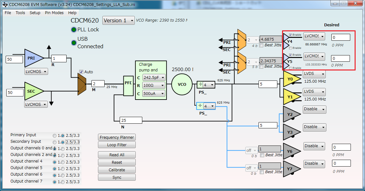

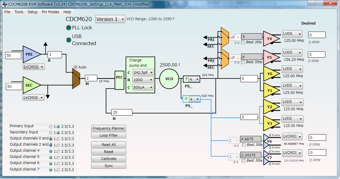

    If you can check, please tell me the following current consumption in two settings that I attached.
    Sorry for many check point.

    Case1
    Case2

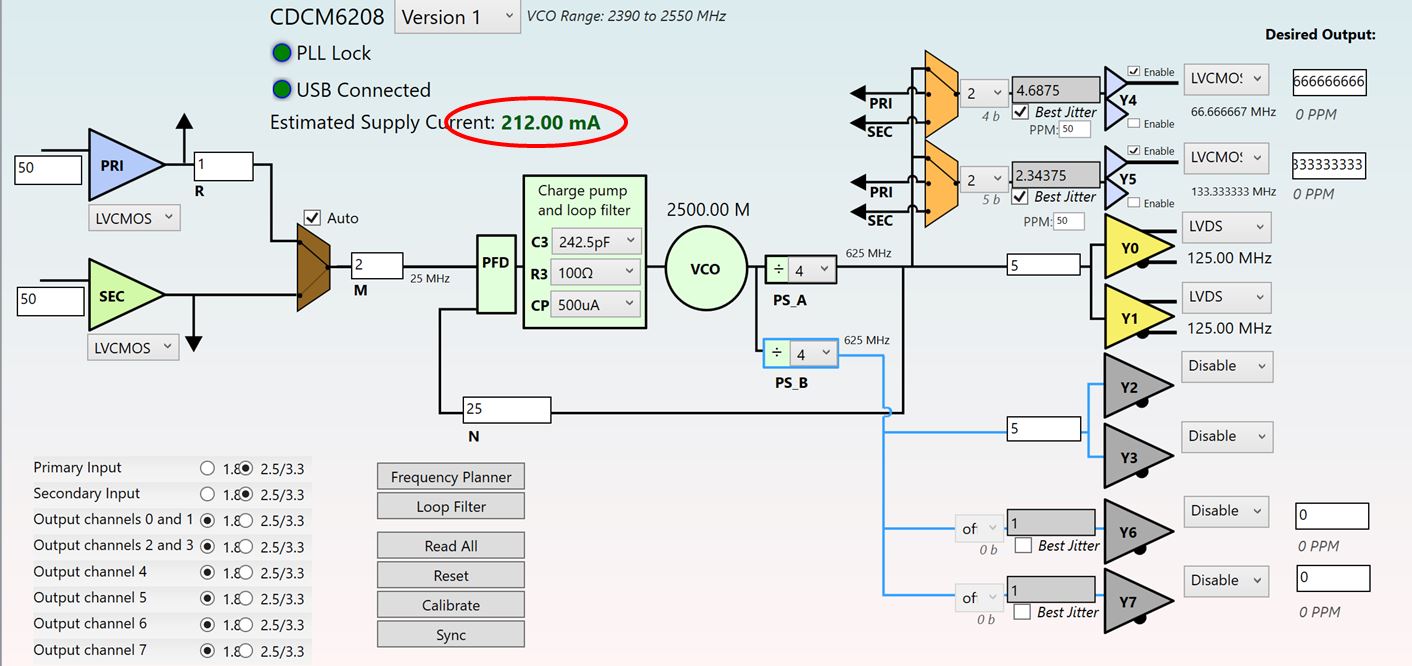

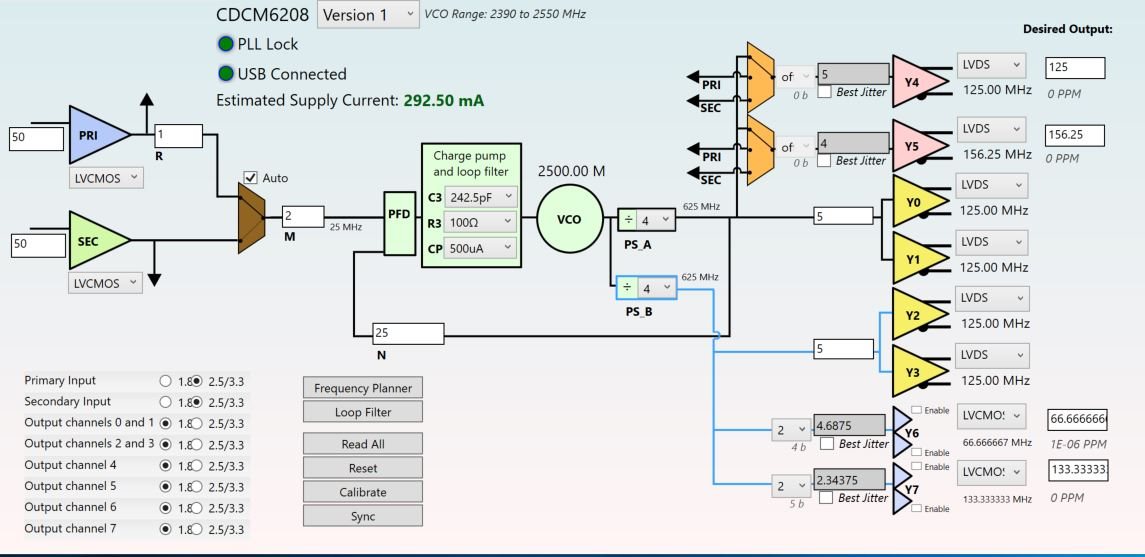

  • Hi Sho
    Here it is:
    You can also use TICSpro. This device is now available there and current consumption estimator is also available there.

    What version is CDCM6208EVM software? My version is 3.24.
    I can't see the Estimated Supply Current,,,,

    I use the same CDCM6208 version like you used (3.24). In your case, some lined are clipped on the software interface. This can be due to the screen resolution. Can you change the screen resolution and check if you see the interface similar to what i posted?
    Sorry, TICSpro update is not released yet, it will be on web very soon. We don't have a option for split current for individual supplies on those softwares, but it is easy to find by just enabling & disabling the blocks from the software to see how much current changes.
    Please try changing the screen resolution, let me know if that does not work.
