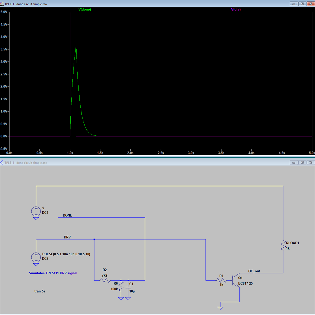

I want to use the TPL5111 as a common but ultra low power timer like a 555. I want the DRV pin to be high for ~100ms every ~5s. I was thinking of using a resistor and capacitor to drive the DONE pin ~100ms after the DRV pin is set high. Is this possible?

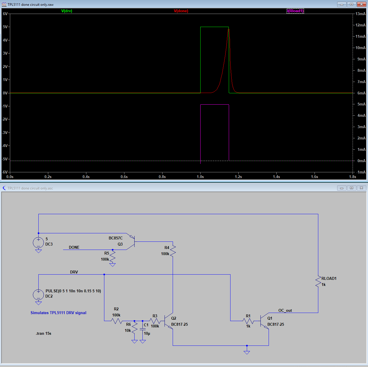

  • Thank you Puneet, hope to hear from him/her soon. I have a RC-transistor circuit in sim that could do it, but I think its better when its RC only.

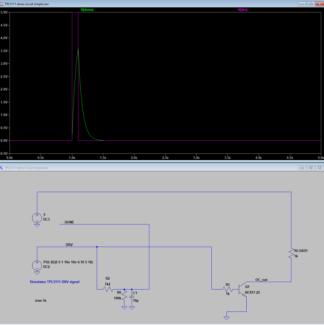

  • Hi Siva,
    Thank you for your reply. I can't use the normal 555 series due to battery life. My question is actually if you could provide me the calculation or advice values in order to do this with RC only, without using transistors.
    I was thinking about using it like below but I don't know the DONE input circuit and characteristics and the DRV output circuit and characteristics to know if I will face any problems with a circuit this simple. And, I don't know how much deviation there is in these characteristics due to production variables and ambient temperature.
  • Thanks Erik,
    The base current for Q1 will be almost 4mA (assuming VBE of ~1V). Do you really need to drive a transistor & charge 10uF cap for your battery operated solution?
    Typically TPL devices drive a small FET or Enable input of a LDO/DC-DC converter to switch on the power. Lets take this discussion off-line to get to know more details about your requirements.
    Siva.

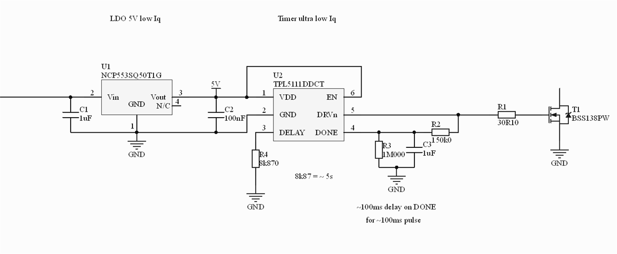

  • Hi Siva,
    Thanks, I managed to get a 100ms pulse every 5s with the schematic below, it workes great and has a total Iq (including LDO) of 2,5uA:
