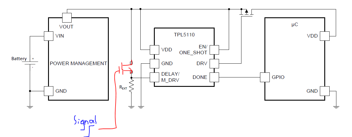

Dear E2E,

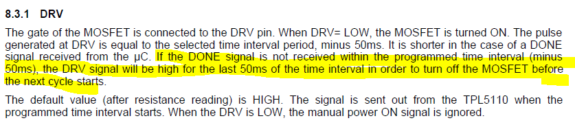

1. May I know if DELAY/M_DRV pin (pin3) connect to VDD, the MOS will turn on forcibly (Means DRV goes low), right?
2. As the same condition, When DELAY/M_DRV pin (pin3) connect to VDD, IC don't count time, so don't reset the count, right?
3. Could I use the design as below?
When Signal goes high, DRV goes low forcibly (MOS Turn ON)
When Signal goes low, pin 3 calculate the time and start to count
