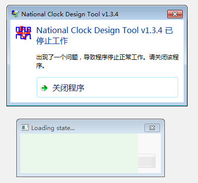

LMK04828: Clock design tool crash when load program state. OS is win7 sp1 64bit.
Part Number: LMK04828
    "National Clock Design Tool" could load the .sav file generated by the corresponding version, there are some compatible issue to load old version .sav file (for example, 1.3.4 can't load 1.3.3 file in some devices) , like you crash issue. So now please try to use the latest version 1.3.5
    When you save a simulation setting into a .sav file, you could mark the version 135.
