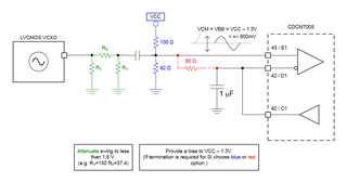

We want to use CDCM7005 to improve clock jitter. The evaluation board (CDCM7005-SP Evaluation Module) is configured to work with PECL VCOs although we plan to use LVCMOS 100 MHz VCXO. The board is populated with PECL terminating resistors (130R to Vcc and 82R to GND) for both VCXO_IN and VCXO_IN_N inputs and there is a pin providing VBB  to bias unused complementary input.
My question is: what is the proper way of interfacing LVCMOS VCXOs to CDCM7005?
I plan to:
- remove terminating resistors from PCB at VCXO_IN_N input (R31, R36). Connect input to VBB bias volatege via jumper (R28).
- remove terminating resistors from PCB at VCXO_IN input (R38, R43), remove AC-coupling (C17 - jumer 0R).
Please share your comments.
Kind regards,
F.

  • Dear Filip,
    This is a good question. I suspect you will want a voltage divide on the LVCMOS to get to move +/- 800mV as PECL does and set common mode to 2V on each leg. Let me check with a team member and we will get back to you.
    thank you for your patience.
    Regards, Simon.
  • Hello Filip,
    here a visual clarification for Simon's suggestion.
    • Ensure the signal swing is lowered below < +/- 800 mV at the pin
    • The complementary pin !VCXO_IN shall be biased to VCC - 1.3 V. You can use the VBB pin for convenience. We recommend to place a decoupling cap on the VBB to keep it stable.
    • The attenuated VCXO signal should be AC coupled. You can use 100 nF as a start value.
    • The AC-coupled and attenuated signal common mode should be close to the threshold voltage via VBB. You can either keep the pull-up/down termination or terminate with a resistor to VBB. The values depend on the drive capability of your VCXO.
