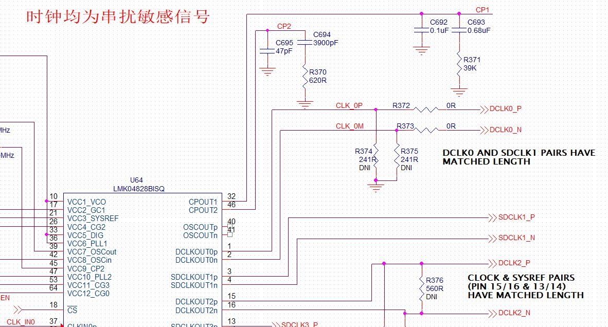

hello, the schematic of lmk04828 is as follows, the PLL1 cannot locked, I calculated the loop bandwidth is 42.416Hz and the Phase margin is 15.782, should I modify the loop filter for PLL1?
