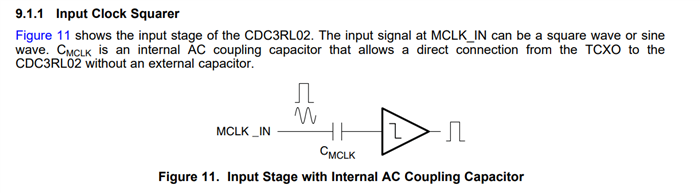

I designed my clock circuit using CDC3RL02, I have a question about MCLK_IN of this buffer.
Does the buffer accept an AC-coupled clock signal as input for MCLK_IN? (The input signal into MCLK_IN in my design is as AC-coupled sinusoid signal from OCXO)
It is specified the specification of MCLK_IN on page 6 the datasheet as below. I think this means that input signal into MCLK_IN should be DC-biased signal.
But, on page 11 of the datasheet, there is an AC-coupling capacitor inside the MCLK_IN input as below. I think this means that an AC-coupled signal is also acceptable. So, I am confused. Is it possible to be applied AC-coupled sinusoidal clock into MCLK_IN?

  • You can apply an AC-coupled signal to MCLK_IN. The AC-coupling capacitor is included on the MCLK_IN pin as indicated in Figure 11, therefore CDC3RL02 will also accept a DC-coupled input.

    1. The range of MLCK_IN on datasheet limits negative signal in Absolute Maximum Ratings to -0.3V and to Zero volt in Recommended Operating Conditions. On other hand it shows AC coupling inside, it means AC-coupled signal is acceptable as you said. These parts are contradictory. How is your thought?
    2. I actually tried applying an AC-Coupled signal to the input pin. When the Vp-p of the signal is about 500mV, the buffer generates duty-cycle distortion. What exactly is the voltage threshold of the input?
  • Q1. The range of MLCK_IN on datasheet limits negative signal in Absolute Maximum Ratings to -0.3V and to Zero volt in Recommended Operating Conditions. On other hand it shows AC coupling inside, it means AC-coupled signal is acceptable as you said. These parts are contradictory. How is your thought?
    A1. Thank you for pointing out the MCLK_IN datasheet limits. The datasheet is incorrect. I will update the MCLK_IN limits in the next revision.
    Q2. I actually tried applying an AC-Coupled signal to the input pin. When the Vp-p of the signal is about 500mV, the buffer generates duty-cycle distortion. What exactly is the voltage threshold of the input?
    A2. What distortion are you measuring? For a 50% duty-cycle input, the output duty cycle will be 45% - 55% (see datasheet table 7.5).
