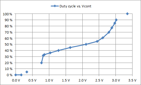

    Let's look at this circuit. Output goes high just after "clock input" and it will stay high until just after timing capacitor voltage exceeds "modulation input". At that point output will go low if "clock" input is high. Therefore the negative pulse width of the "clock input" must be less than the lowest positive pulse width needed. Also the rise in capacitor voltage is not linear it is exponential. Therefore the positive pulse width vs "modulation input" is not linear. Does it need to be linear?
    What is the minimum and maximum duty cycle or pulse width is required?
    1) Yes, input 1MHz
    2) Clock input low level must be less than 1.1V ideally near 0V, high level must be greater than 1.1V; near 3.3V is fine.
    3) No not 50% (however there is a way to improve linearity)
    4) Pin 5 input range is about 0.5V to near 3.3V
    5) I will provide these later.

  • Daniel,
    The TLC555 did not perform well in this application's frequency request.
    Input was a 1 MHz 50% duty cycle clock. VCC = 3,3V; Control voltage tested from 0V to 3.35V
    The missing section of the curves indicates the output waveform was inconsistent (flaky) at low control voltage and 500 kHz output at high control voltage.
    There was about 160ns propagation delay from trigger input to output going high. So TLC555 is not fast enough.
    The results indicate that TLC555 is not a good fit for this application need.
    I suggest using a triangle wave generator and a high speed comparator to get a 1 MHz PWM instead of TLC555
