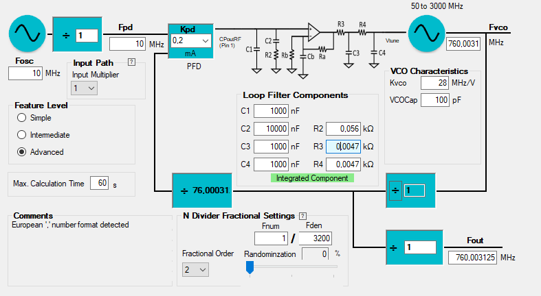

    PLL configuration is shown in the following figure:
    The spurs are the primary fractional. Channels frequencies can be each 6.25 KHz. Primary fractionals are 6.25KHz, 12.5KHz,25KHz and 31.25 KHz.

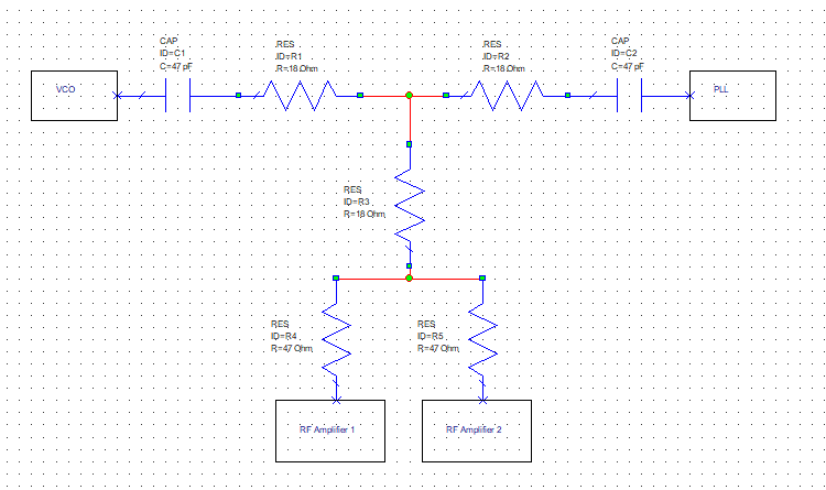

    The way to connect VCO to PLL is show as follows:
    It is observed that if R2 is increased , for example 1Kohms, fractional spurs are reduced more than 5dB although PLL input level  is reduced , too. Due to this effect, I think that could be crosstalk as indicated in AN-1879 Application Note.
    Input level for PLL is calculated in simulation using the input impedance (vs. frequency) included in data sheet.
    RF output level for VCO is about +3 dBm.
    Could these primary fractional spurs be reduced in another way? In fact, the current for PLL (Kpd) is reduced to minimize the spurs, too.
    Thanks in advance.

  • Hi Pedro,
    For this kind of spurs, right, reducing the loop bandwidth is the most effective way of spurs reduction.
    Another thing you may try is to use 3rd order modulator. I think this setting should be better than 2nd order.
    you may also try to enable dither, phase noise may increase in return for a smaller spurs.

    Yes, I have already reduced slightly the loop bandwidth (increasing R4) and I have adjusted the PLL input level to meet the data sheet specification (Min. -15dBm) and with these two changes, the requirements of spurs attenuation are met.
    I had already checked order 3 for delta-sigma modulator, but the sub-fractional spurs are increased, and EVM of oscilator is slightly decreased.
    Related to dither,this could be another option but noise phase is increased and this parameter is critical for our application.
    The results reducing the loop bandwidth and adjusting the input level of PLL are OK.
    Thank you very much for your support.
