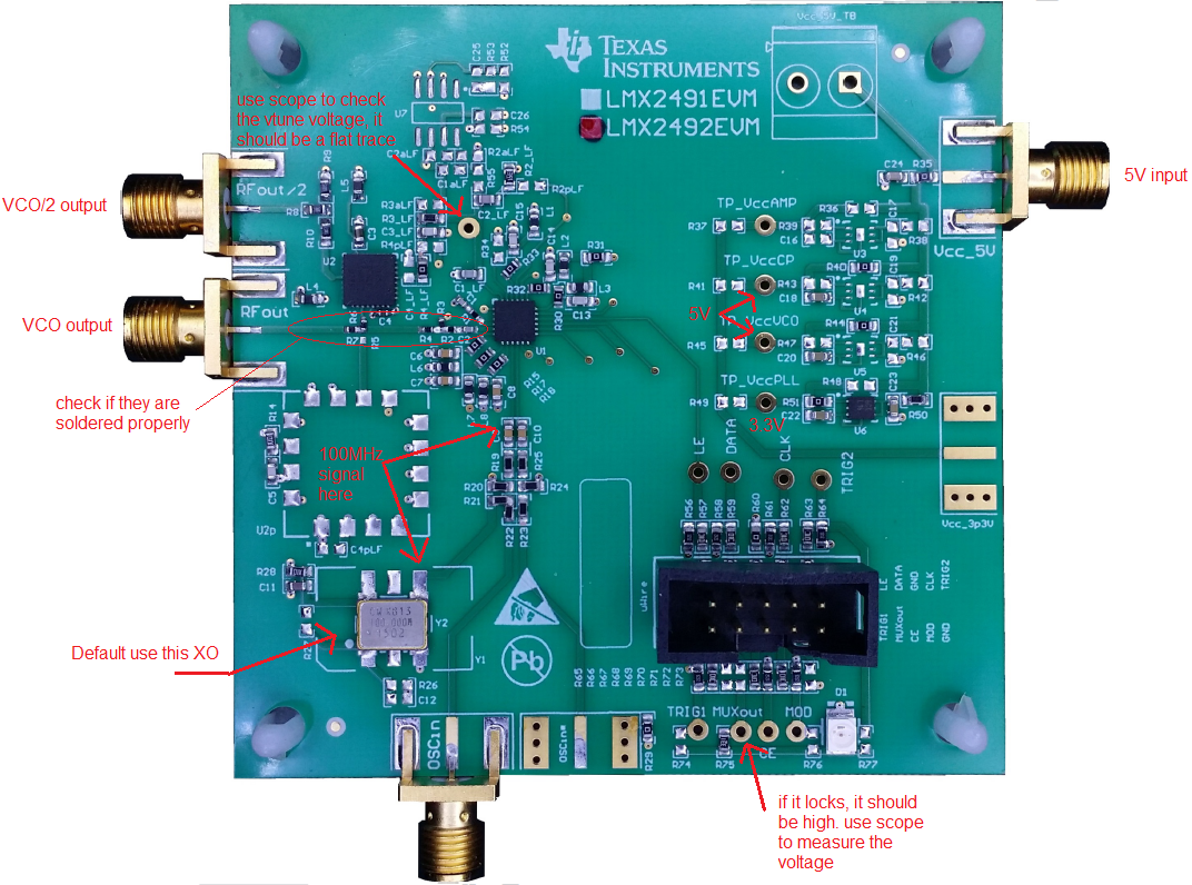

I've been trying to get the LMX2492 to work, just to replicate the continuous sawtooth ramp in the EVM user guide.  I have trouble changing the VCO frequency, and can't see any ramping at all.  I cannot replicate any of the user guide examples.
I can tell the board is alive, toggling the PowerUp/PowerDown register changes the current draw by maybe 20 mA.  Similarly, when I set the Mod, Trig1, and Trig2 pins to be input, I can watch them go high and low when I toggle the checkbox in the GUI, monitoring them with my multimeter.  On my Spectrum Analyzer, when there is 5V going to the the EVM, in Power Up mode, I see a CW signal a 4.46 GHz out of the RF/2 port.  In Power Down mode, I see 4.51 GHz.  Changing the VCO GUI field makes no change on the output.
I'm hopeful maybe I have a setting wrong.  Or maybe there is a blown passive in the VCO chain, because it is suspicious that the CW sits right at 9GHz, when the EVM documentation says it should go from 9.4 to 10.8 Ghz.  When I put in Default Configuration from '2016 - 6 - 17', I have no improvement or change.  However, I'm holding onto the fact that I haven't had the 'Write Error' that I had when my LMX2595 board seemed to brick.
What do you recommend?  Please and thank you for your help,
Darren

    3. Check Input Frequency -- I think this could be the issue
    Ensure that you have 100 MHz input frequency. Yes, there is an XO on the board, but it is NOT powered up or hooked up by default. Ensure you see the 100 MHz input at the pin. So start with a 100 MHz input to the OSCin input SMA and verify that it is making it to the pin on our device.
    4. Check VCO Output
    Realize that the LMX2492 does not create an output, but only steers the VCO output. I don't know the exact range of the VCO, but it is wider than 9.4 to 10.8 GHz, as they have to have some margin. There is also a divide by 2 output. So if you see 4.46 GHz at the divide by 2 output, this means 8.92 GHz at the VCO, which sounds like the VCO is producing its lowest output frequency. I would check the VCO tuning voltage and I bet it's 0V.
    5. Check VCO tuning voltage
    Now try to make the VCO frequency and tuning voltage move. Try toggling the phase detector polarity on the TICSPro GUI from "-" to "+". This typically makes the VCO tuning voltage to go to the maximum value and also I would expect the VCO frequency to move. If you don't see the tuning voltage move, something is suspicuous. Maybe the loop filter is disconnected, shorted to ground, charge pump is tri-stated, ect.
    6. Read back the N divider and R divider outputs.
    On the MUXout (or other I/O pins), you can see the PLL R divider and PLL N divider. On this pin you can see the output of the N and R dividers as the chip interpretes them to be. Ensure that this frequency is correct and that it is not too low (sensitivity problem) or too high (sensitivity or hamrmonic problem)

    I did 2. For 3 I see power going to the XO chip, and I can measure Voltage on the output of the XO, so I think I'm ok there.
    For 4, ya, I was thinking something like that. I measure Vtune as .6V and it doesn't change even when I set the GUI VCO frequency at something different.
    5: Toggling the CPPol doesn't do anything, which I believe is what you meant. So now we're getting somewhere. How would I test those other possibilities you mention?

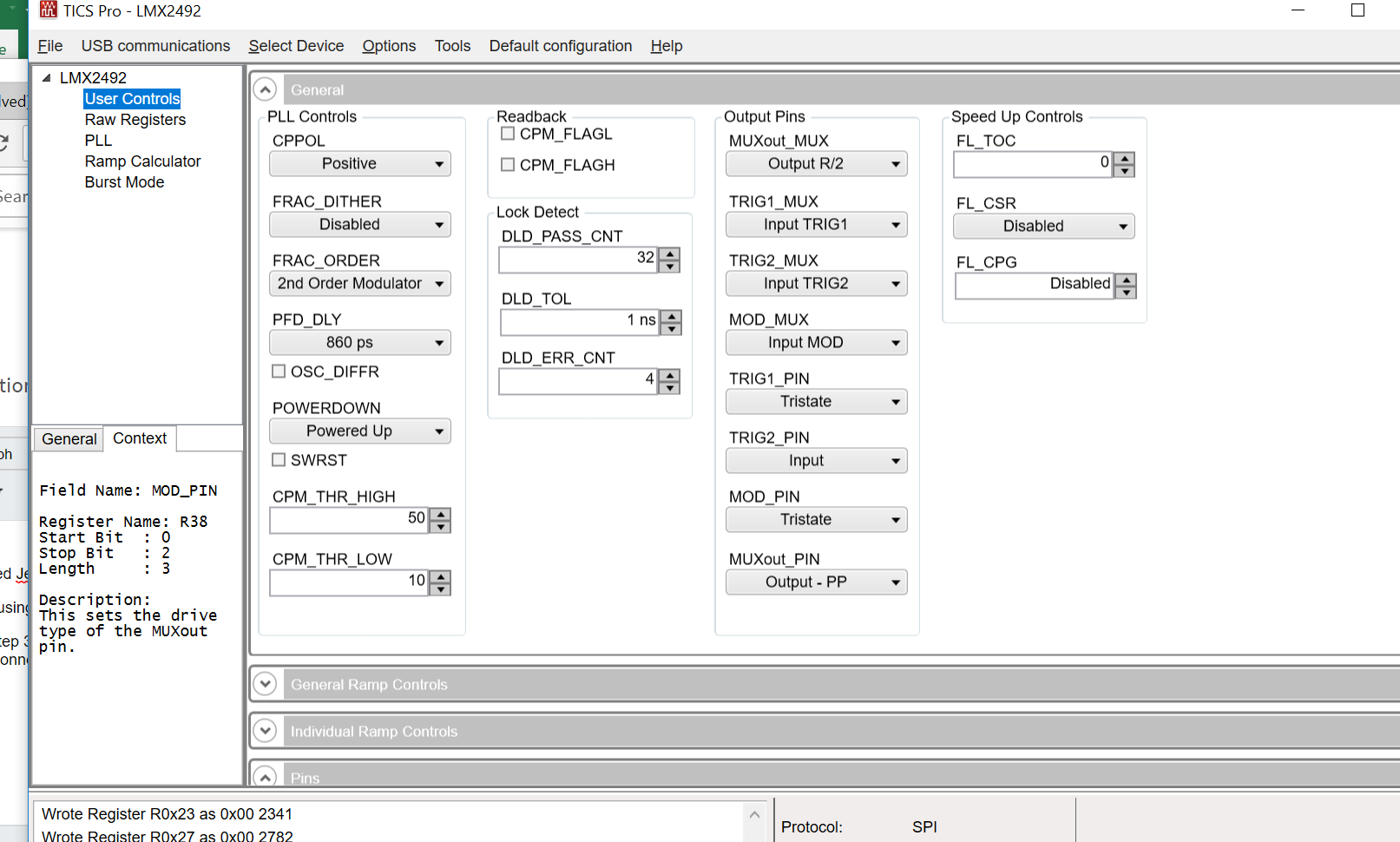

    After setting default mode, cycle power, toggle SWRST bit, and push Ctrl+L to make sure that we start off in a known state.
    2: OK. As we are missing something, we can be absolutely sure of this with step 6. So lets go to the next one.
    6: For this one, we want to see what signal the part believes is at the OSCin pin. To do this, do the following:
    a. Set MUXout_MUX = "Output R/2" state 16
    b. Set MUXout_PIN = "Output PP" State 2
    The output is the frequency after the PLL R divider then divided by 2 again (divide by 2 makes a nice square wave); it's not a number of fixed pulses as you say above.
    Now look at the MUXout pin on the oscilloscope and you should see half of hte input frequency. So if the reference is 100 MHz, you should see a 50 MHz square wave. If you a higher multiple, it could be a haronic. If you see nothing or noise, it could be a sensitivity problem and this implies the signal is not getting to our pin. Realize also that if you have no signal going to this pin, it can self-oscillate, although it will be way off from the target freqeuncy. If you are absolutely sure that there is indeed a signal at the OSCin pin, yet the part says nothing is there, consider some ideas. First of all, signal should be AC coupled and bias level on OSCin pin should be Vcc/2. If it is some issue with the pin, try driving the other compliementary output pin and see if there is some issue with the pin.

    Yes I'm using TICS Pro.  I loaded all the defaults like you instructed.
    I redid step 3 from your earlier post, and found there is no clock coming out of the XO on the EVM board.  Power is going in, but no clock.  I cannot tell why it isn't connected, on the schematic and the board itself it seems connected.  Ok, so I connected a 100 MHz clock into the OSCin SMA like you suggested.  Then I connected my scope to the MuxOut pin, set to R/2.
    I KNOW I'm sending in a 100 MHz clock, but I can't see anything on the MuxOut R/2 pin.  I have tried it on the other I/O pins as well.  I also connected the pin to my Spectrum Analyzer and could not so the signal at 50 MHz.
    So somehow the board cannot see the 100 MHz signal properly.  Hopefully a phone call can clear this up.

    1. Toggle the VCO phase detector polarity, it should cause the VCO to jump frequencies. But some parts use the OSCin pin to clock in programming bits, so if it doesn't work, it doesn't fully convince me that it still cant be related to the OSCin pin.
    2. Set the charge pump to "Disabled" in the TICSPro GUI. This disables the charge pump. Then apply a voltage of say 1 V and see if you can move the VCO voltage this way.
    I think that the "write error" is a red herring. This error has nothing to do with the actual device, but rather something with TICSPro. TICSPro is basing this error in any way based on how the device responds.

  • I also just checked after C9, so at the 2492 OSCin pin, and I very clearly see a 100 MHz signal. So when you say the OSCin pin might be blown, do you mean INSIDE the 2492?

    Powerup/Power down test only makes 20 mA difference, but should make 60 mA difference. Sounds suspicious like unconnected power supplies. The board has a 5V supply for the charge pump pin, but it also has a bunch of 3.3V pins. that are supposed to be supplied by regulator U6. Can you verify this is the case? Can you verify that:
    a. Vcc_3p3V SMA launch pad is at 3.3V (driven by regulator)
    b. TP_Vcc_VCO test point is at 5V (pretty sure it is)
    c. TP_ Vcc_CP is at 5V
    d. TP_VccPLL is at 3.3V

    A) The power pin of the 3.3 SMA pad is not driven. But I think that's because R49 is unpopulated. The Test Point at VccPLL is at 3.3V
    B) This is at 4.92V
    C) This is at 4.92V
    D) This is at 3.3V
    Just for ducks, I also checked that voltage after R30 and R32 are in fact 3.3V, and they are.
    I don't have a 50 Ohm load on OSCinN because the pad isn't populated with an SMA. But at this point, I actually took off my Signal Generator and can see the 100 MHz coming from the XO at the C9. I could connect an SMA on the pad and try and drive OSinN, but how would I turn off OSCinP?
    I think your assessment of the VCO railing sounds right. And then when I applied 1V and 2V to the VTune, it jumped up by maybe 40s of MHz.

    I just got in a new 2492 board, and all the functionality works fine. I don't know what is wrong with the original eval board. But I'm moving forward. Thanks for your help,

    It seemed that the problem was the original board had a hardware issue, possibly with the OSCin pin.  Whatever it is, it seems that there is now a working board.
