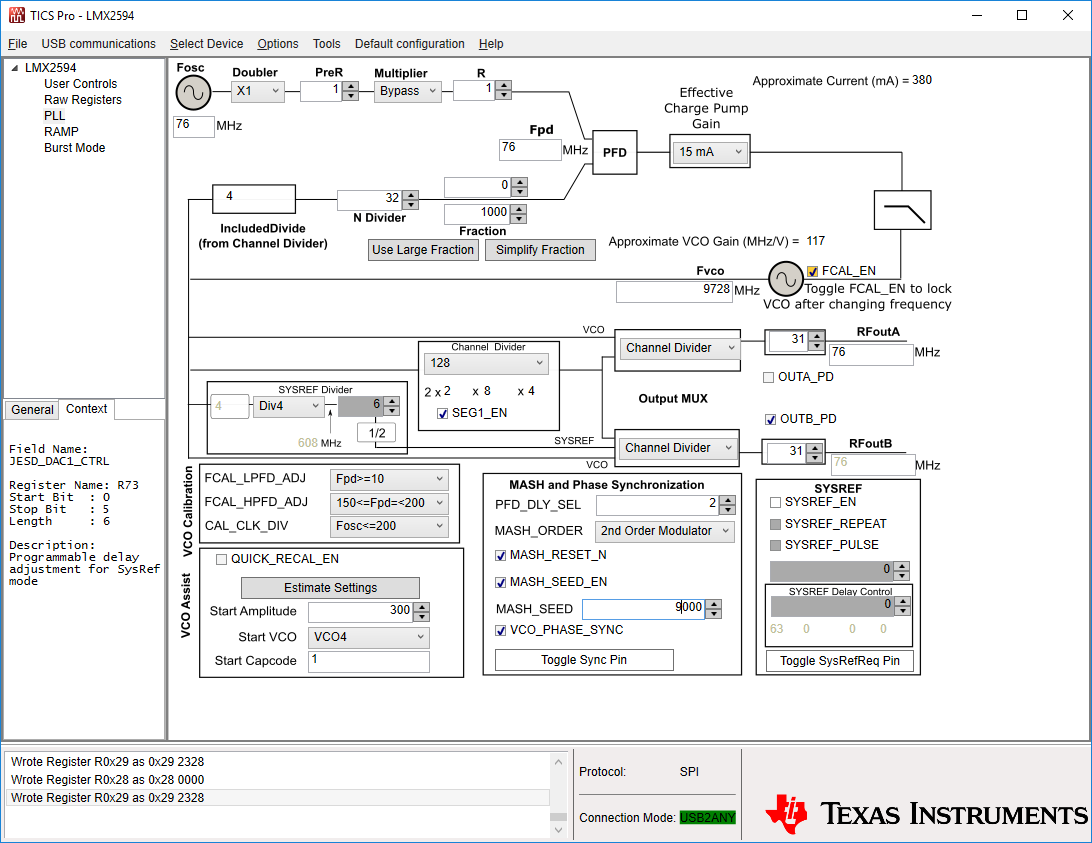

I read in the LMX2594 manual that it is possible to alter the phase of the output by varying the MASH_SEED variable in the TICS Pro GUI - which I have been able to confirm to a certain degree. However, I have been trying to achieve an exact phase shift by altering this variable but am really struggling to comprehend what parameters determine the exact phase shift imparted.
On page 31 of the manual it states that
Phase shift in degrees = 360 (MASH_SEED / PLL_DEN)  ( IncludedDivide / CHDIV)
Where PLL_DEN > PLL_NUM + MASH_SEED i.e. MASH_SEED <= PLL_DEN - PLL_NUM. What happens if this condition is violated?
If I am interpreting these variables correctly from the TICS Pro GUI I do not see anything like this relationship. On the same page of the manual it seems to suggest (its not written clearly!) that VCO_PHASE_SYNC needs to be 1 for this phase shifting to work - is this true? I also do not know how I can determine (or alter) the FRAC_ORDER from the TICS Pro GUI.
Could somebody advise how the exact phase shift imparted can be determined from the parameters under one's control?
I hope someone can help.
Many thanks,
Matthew
p.s. Screenshot below - in this case the expected phase shift should be 360*(9000/1000)*(4/128) = 101.25 degrees. Is this correct? Does VCO_PHASE_SYNC need to be 1?

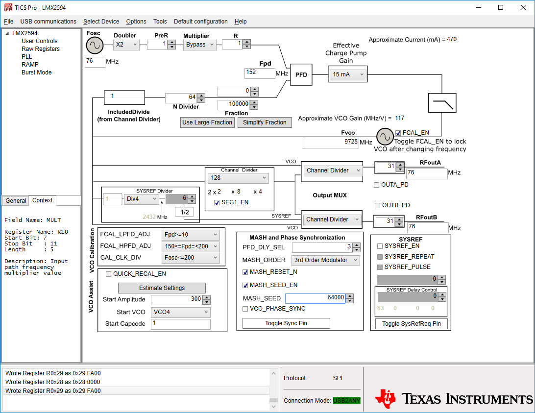

  • Dear Mr Banerjee,
    Many thanks for your swift response. I have tried again just now and still cannot get expected behaviour. Do you have any idea why the following does not produce a 180 degree phase shift?
    Both PLL_N and MASH_SEED are within range.
    Many thanks,
    Matthew
  • Hi Matthew,
    At a glance, you should not check the box for MASH_RESET_N.
  • I realise that in the example above the PLL_DEN should have been 1,000,000, but even that still doesn't work. With PLL_NUM = 0, 0 <= MASH_SEED/PLL_DEN <= 1, meaning the maximum phase step size should be 360/128 = 2.8125 degrees. However, I cannot get the phase shifting to work at all now!

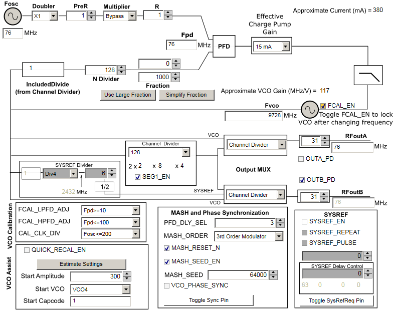

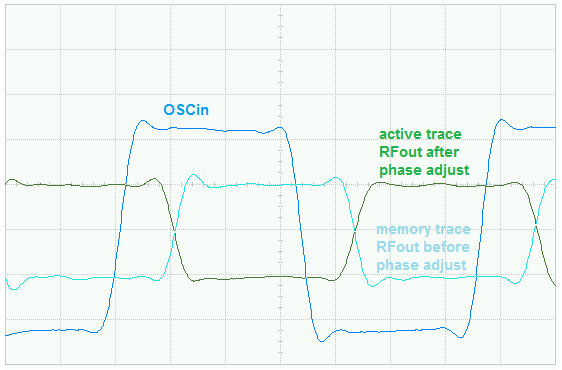

  • Hi Matt,
    OK, here is the test result.
    1. Program the device as follows with MASH_SEED_EN = 0 and MASH_SEED = 0. You should get it locked at 76MHz output.
    2. Program MASH_SEED_EN = 1
    3. Program MASH_SEED = 64000
    4. You should get 180 degrees phase shifted (= 360 x SEED /1000 / 128)
    OSCin is used as the trigger channel.
  • the first picture should be this one.
  • Thank you Noel. A few points:
    1 .Your oscilloscope traces do not evidence any phase shifting.
    2. PLL_DEN needs to be >= MASH_SEED. You need to change PLL_DEN to 1,000,000.
    3. MASH_RESET_N is active low, meaning it should be checked so as not to reset the MASH function (I think!).
  • I now realise that you have included the before and after in the same trace which you have included twice. I can see the phase shift but cannot reproduce it.
  • I continually tried following your suggestion but have not been successful. I would be ever so grateful if you could try again using the settings I have below and let me know if it still works. (Notice that the doubler is x2).
  • Update - setting the doubler to x1 allows me to reproduce your phase shift. However if I set the doubler to x2 it doesn't work anymore. I attempted to change PreR and R too and they also break the phase shifting.
