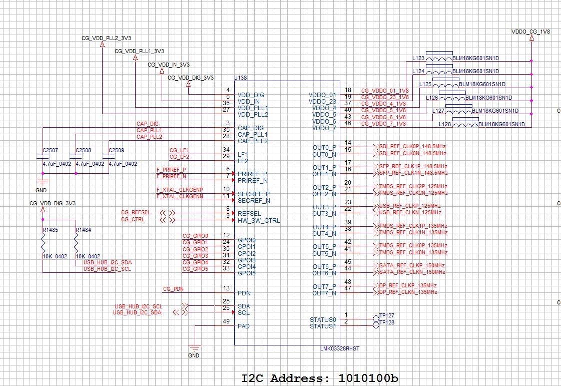

Confused with the TICS Pro software for calculating the required PLL.
Below is my requirement. Can anyone please help me with this implementation ASAP.
The input is 25MHz on SECREF. And PRIREF is not present.
Thanks & Regards,
Nanjunda M
  • Hi Nanjunda,
    I reviewed your schematic. Unfortunately you cannot use one LMK03328 to generate all of four of the frequencies.
    Here is some schematic feedback for using LMK03328 to generate the 125MHz, 135MHz, and 150MHz rails:
    • Replace C2507, C2508, C2509 with 10uF capacitors
    • Rearrange outputs for best performance:
      • VCO1 = 5250 MHz
      • VCO2 = 5400 MHz
      • OUT0 = 135 MHz
      • OUT1 = 135 MHz
      • OUT2 = 135 MHz
      • OUT3 = 135 MHz
      • OUT4 = disabled
      • OUT5 = disabled
      • OUT6 = 150 MHz
      • OUT7 = 125 MHz
    • I recommend the following loop filter capacitor values
      • CG_LF1 = 3.3nF
      • CG_LF2 = 3.3nF
    Kind regards,
    Lane

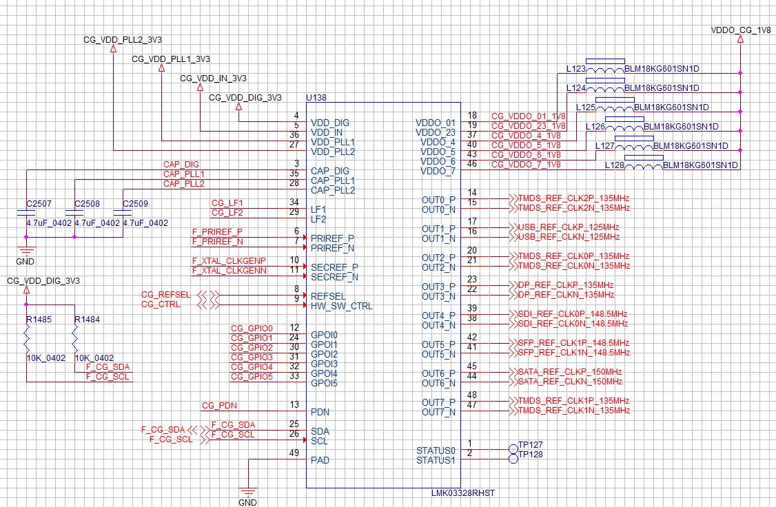

  • Hi Lane,
    Changed a bit of the schematics.
    Please find the below.
    Output0: 148.5MHz
    Output1: 148.5MHz
    Output2: 125MHz
    Output3: 125MHz
    Output4: 135MHz
    Output5: 135MHz
    Output6: 150MHz
    Output7: 135MHz
    Could you please help me with, options for input REFCLK's i.e. PRIREF & SECREF.
    Thanks & Regards,
    Nanjunda M

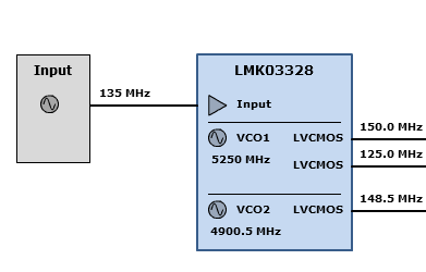

  • Hi Nanjunda,
    Before there were four copies of 135MHz and one copy of 125MHz. Now there are three copies of 135MHz and two copies of 125MHz. Which is correct?
    Assuming your most recent post is right, I recommend to switch OUT6 and OUT7 so that the 135MHz outputs are adjacent. You can use 135MHz on PRIREF and bypass to OUT4 / OUT5 / OUT6. You can use this 135MHz reference to generate the 125MHz, 148.5MHz, and 150MHz as well.
    (this image doesn't show the 135MHz bypass on OUT4/5/6)
    The option in the image above was found using the WEBENCH Clock Architect Tool. Use this tool to find different clocking solutions for your application:
    Kind regards,
    Lane
