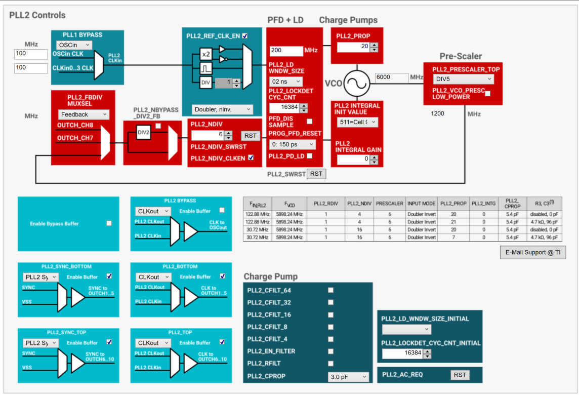

Is there a tool like "Clock Design Tool" to help in the design of the LMK04610?

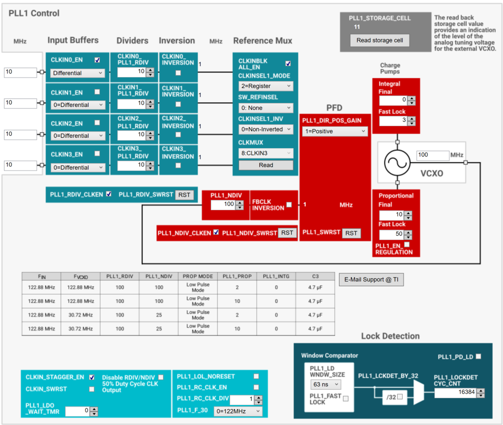

You can use 100MHz VCXO for this frequency plan. Here is an example configurations:

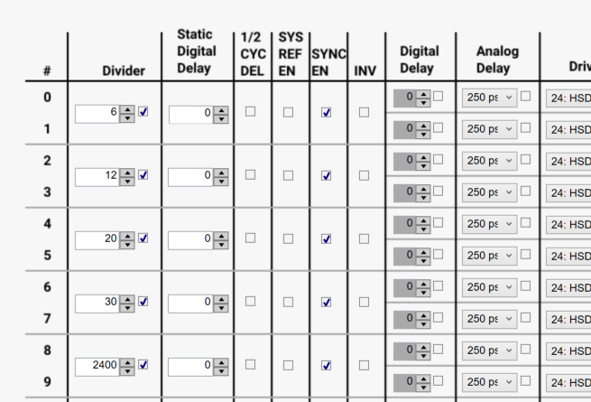

VCO for PLL2 is running at 6GHhz and Prescaler 5 is used resulting in clock distribution frequency of 1200MHz. Following outout dividers will result in all the frequencies you are mentioned:
