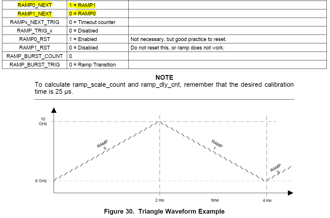

       Can you show me an example about how to generate sawtooth with LMX2595? The user guide only talked about triangular wave. Please let me know what should I set in GUI.

    Sawtooth is very easy, you only need one ramp.
    Looking on the ramping setup example on page 22, all you need to do is change RAMP0_NEXT from "RAMP1" to "RAMP0".  Because RAMP0_RST is checked, it will automatically start back at the beginning frequency.

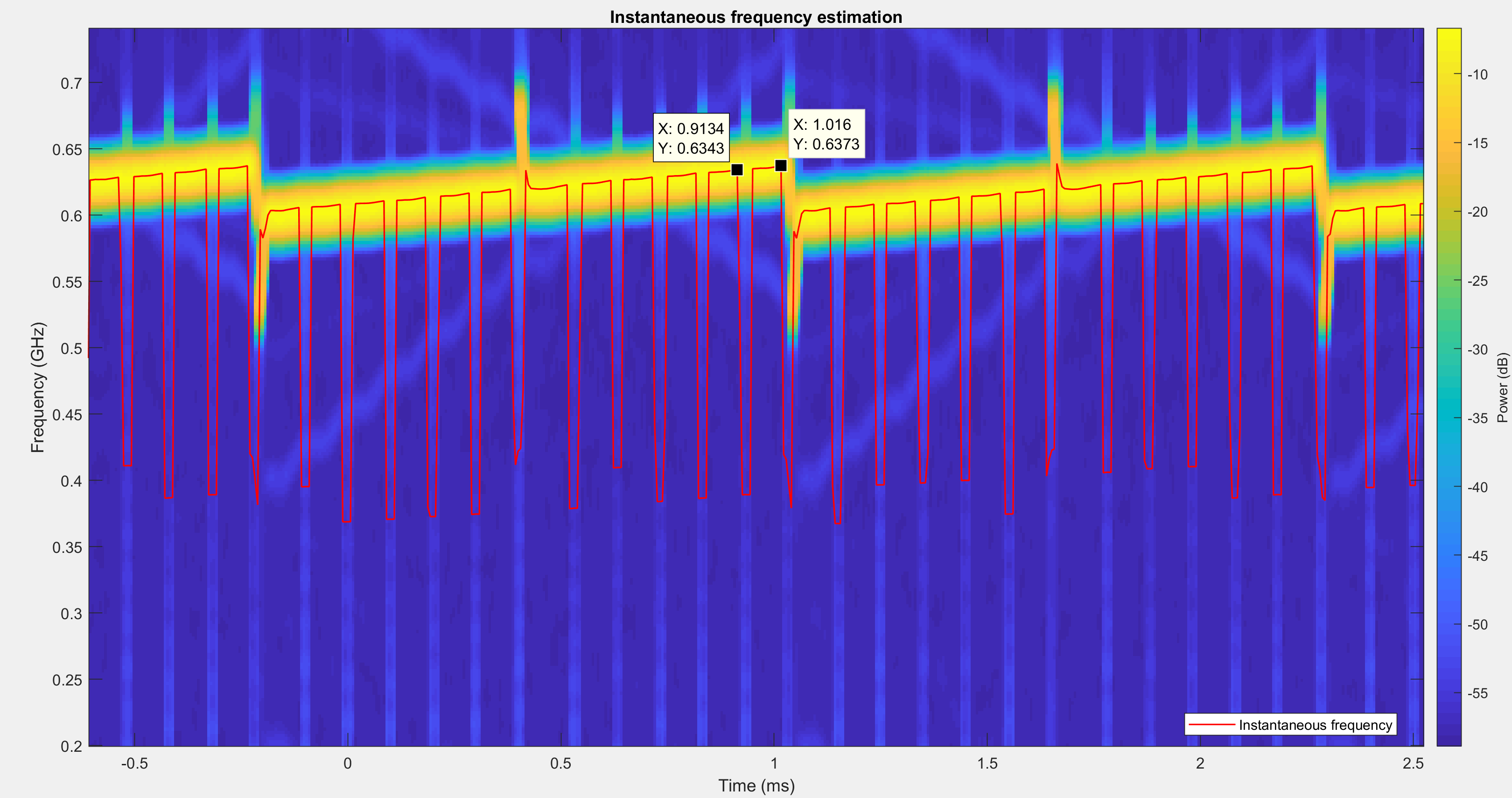

    How can I get a sawtooth without calibration? I just tried to sweep 100 MHz in 100 us only using ramp0, but the ramp is like a triangular wave.
  • Dean,
    Look at the graph. The waveform is so ugly. Can I get a smoother one? Like no calibration?
    Henry
  • To get to the point ... No.  Calibration free ramping is only possible if the VCO frequency changes a small amount.  If we take the frequencies that you have at the output and map it back to the VCO.Henry,

    Did you generate a Sawtooth? Cause I got a triangular wave even I tried to get a sawtooth.
    Henry
  • Hi Henry,
    Datasheet shows triangle wave example, but it is easy to become a sawtooth wave. As Figure 30, when RAMP0_NEXT still is RAMP0, then it is a sawtooth wave.
    TICS Pro GUI could help you check which register could be changed for ramp settings.
