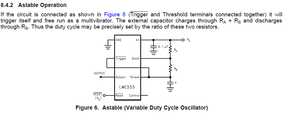

Hi team,
I want to use LMC555 in astable operation, how to connect Control pin, floating or using 0.1uF bypass cap to GND?
Jing
