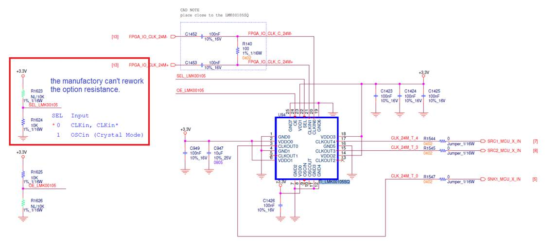

I have used the LMK00105SQ in my small board, right now, we want to design the test board to test my small board in the manufactory.
Could you please suggest how to provide the clock source to LMK00105SQ in my test board?
The snapshot is the LMK00105SQ circuit in the small board.
