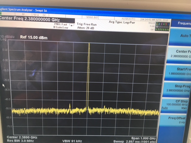

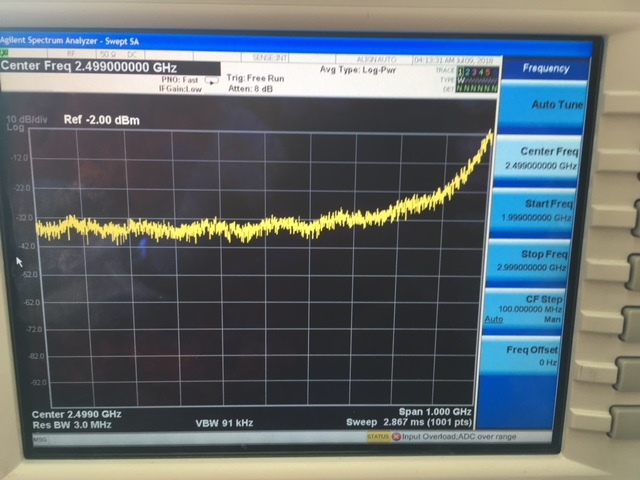

The IC works in two channel mode: OUTA switches between VCO and channel divider to achieve the frequency range 10...15000 MHz and OUTB works with direct VCO frequency as LO for LTC5552 mixer. In the range of ~2.38-2.5 GHz the 1/3F section doesn't work properly. Trying to get the desired frequency at OUTA gives the feedthrough of locked Fvco and 1/2Fvco (the 1/2F section works correctly) and oscillation at additional 1/3F section output. Therefore i see the excess noise and no signal at 2.5 GHz. At 2.38 GHz system works correctly. How can i fix it? The supply voltage is 3.18V.

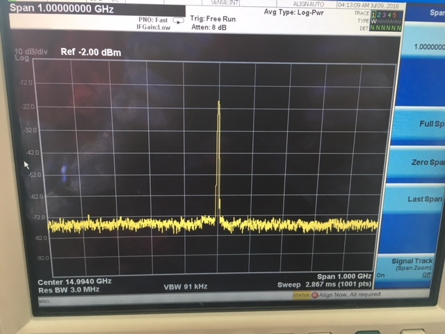

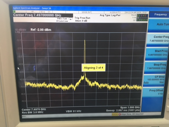

  • Dean, i believe that the bleeding of Fvco and Fvco/3 is normal. In my case it indicates that the PLL is locked and F/2 section works properly. But i don`t see the signal of Fvco/6=2.4999 GHz (instead of excess noise) which must be when i set the CHDIV=6 and Fvco=14.994 GHz. It starts to work at output frequency of ~2.4 GHz. I assume that the section F/3 next to F/2 section doesn`t work at high frequency.
    Table 8 on the page 22 in datasheet. There are the allowable output frequency ranges for each CHDIV configuration are described. I see that the use of CHDIV=6 allows to generate the frequency range of 1.25-2.5 GHz. But not in my case.
    I will try to switch the CHDIV from 6 to 4 in the range of 1.875-2.5 GHz and keep the CHDIV=6 in the range of 1.25-1.875 GHz. Maybe it will help.

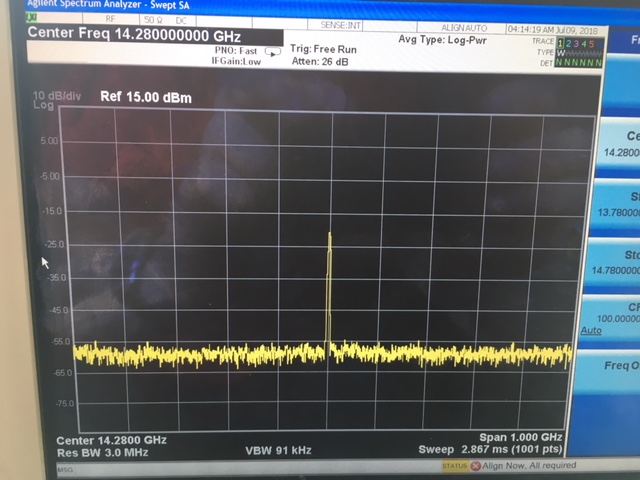

  • I set the overall output division ratio to 6 and set the VCO frequency 14.994 GHz. Of course SEG0 is enabled (R31[14] = 1) and CHDIV setting is 2 (overall division ratio is 6). At the output i see excess noise only. Then i check the VCO and VCO/2 signal bleeding. They are present at the output - PLL is locked and SEG0 works properly. Perhaps the SEG1 with divide by 3 doesn`t work? To ensure it i switch the VCO frequency to 14.28 GHz keeping the output divider settings the same. Now i see a pure 2.38 GHz signal.
    You can see the pictures in my first post.
    BTW. I have changed the division ratio in the range of 1.875-2.5 GHz from 6 to 4 and keep it 6 in the range of 1.25-1.875 GHz. Problem is solved.
