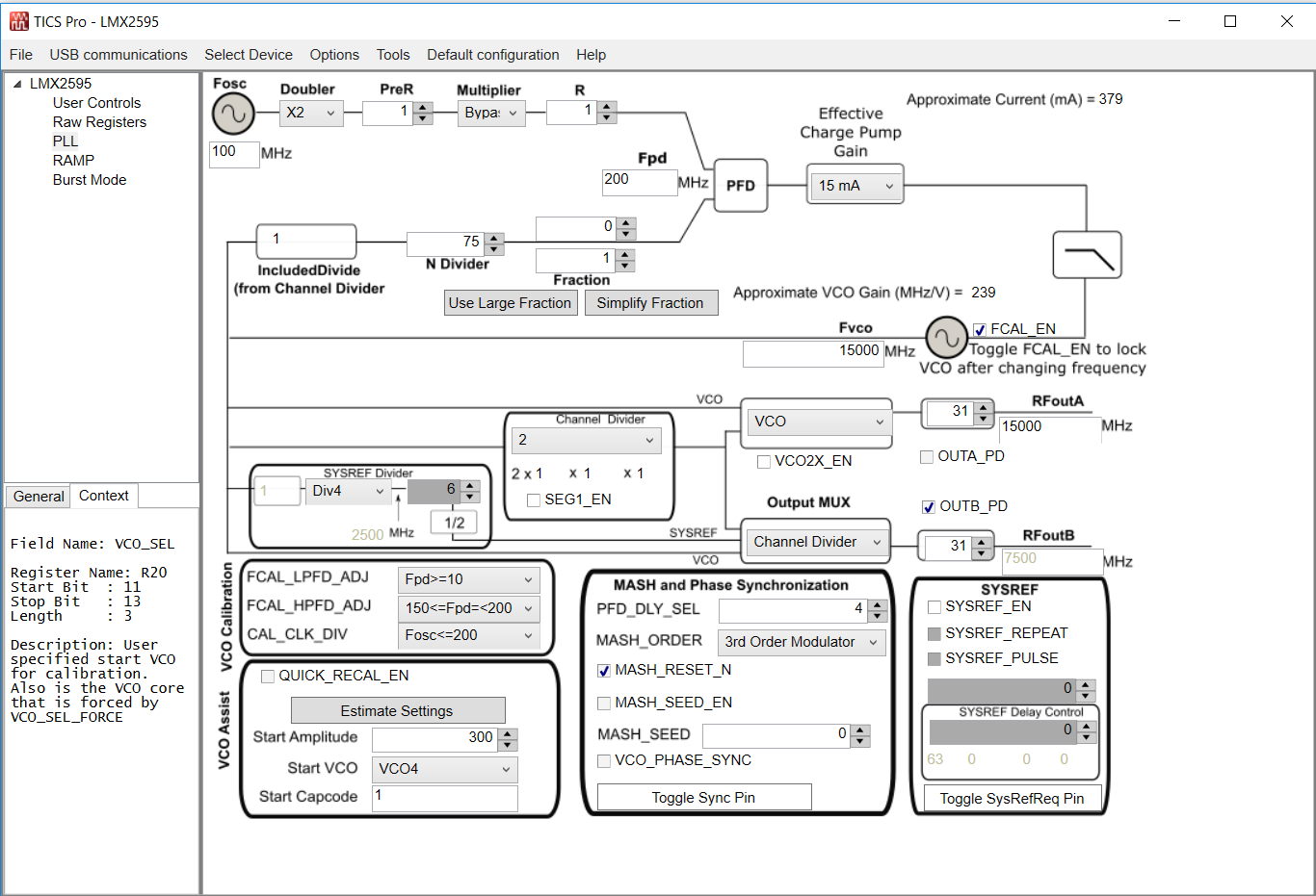

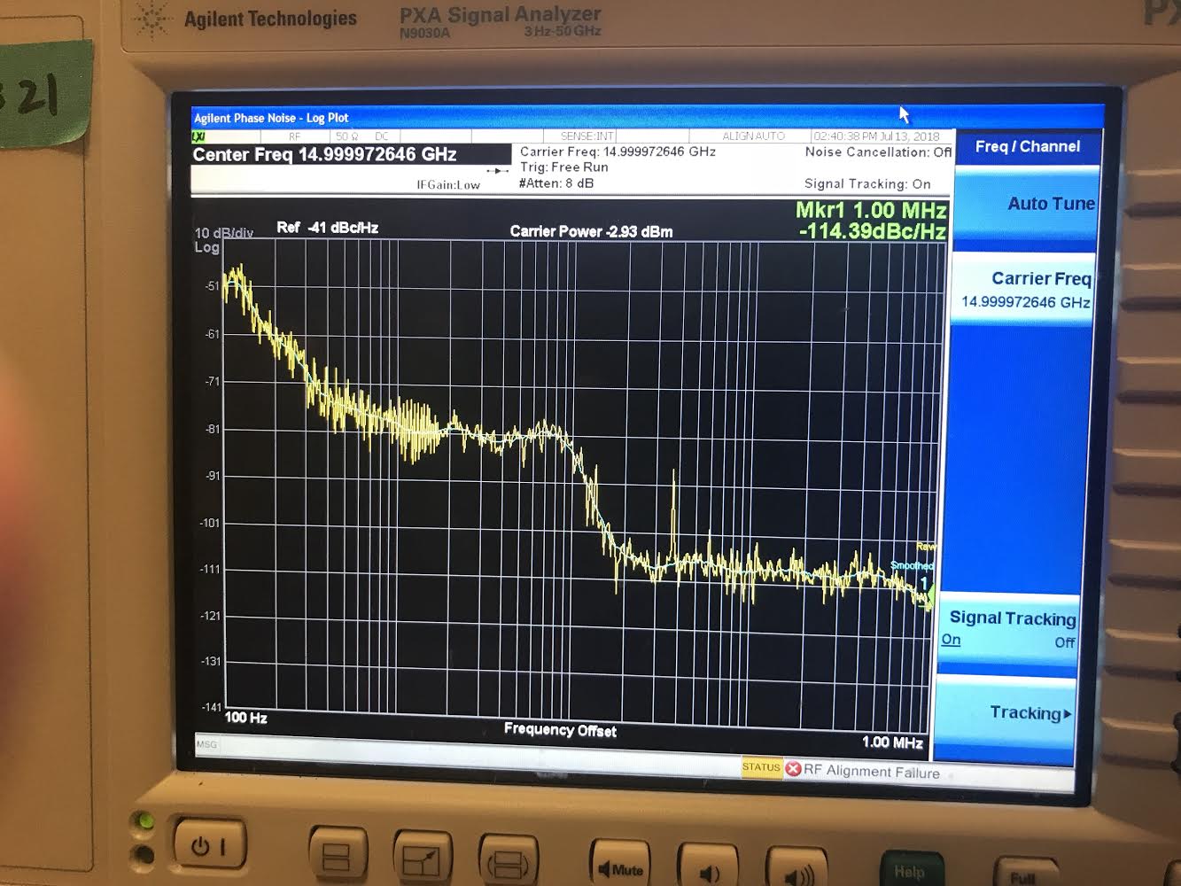

We recently purchased the LMX2595EVM board and when doing a phase noise analysis we received results that were far worse than expected. The phase noise chart generated by our ESA was about 30dB worse across the nearly the entire range. Is there anything that we are doing wrong? I've attached the PLL settings we used from TICS Pro along with the chart generated. We were testing at 15GHz and using the default settings, which I believed the EVM's loop filter was optimized for. Thanks

    Looking at your plot, it seems that for offsets of 20 kHz and higher, you results actually do match the EVM instructions.  However, for offsets below 20 kHz, something is grossly off.  I see three possibilities:
    1.Measurement issue with the PSA spectrum analyzer
    I see that signal tracking is on, but I'm not so convinced that it is tracking very well.  The steep drop off in noise, looks like something that measurement equipment would do.  The PLL is in integer mode and one would not expect fractional spurs at this lower frequency.  I see nothing that would cause the PLL to do this and I have seen strange artifacts of measurement equipment, especially when I see abrupt changes when it switches to a new decade;  I suspect this is the issue.

    Really doubt it, but maybe if configured in some way. I have worked with this device since definition and never seen the device do this, so I highly doubt it is a defective LMX2594 IC. I would go to default mode in TICSPro. If you have the programmable input multipler MULT set to anything greater than 1, then this is a potential uncertaintly. Default mode uses the OSC_2X multiplier. This should be fine, but it's easy enough to disable this. Other than these experiments with the input path, there's not too many other things do do with LMX2594 settings.

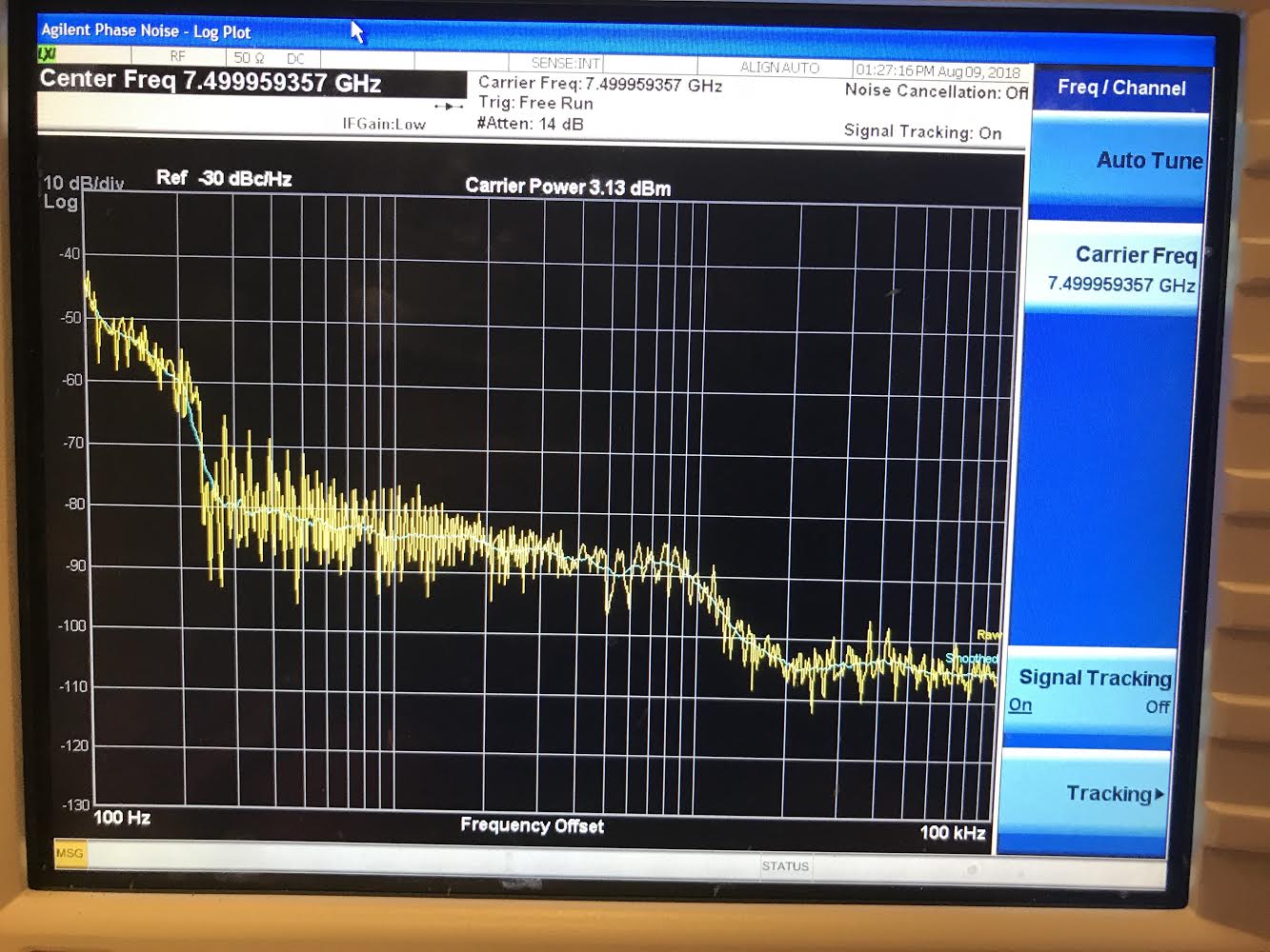

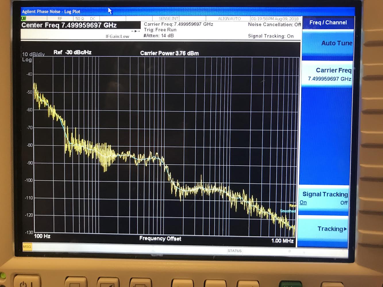

    I just finished following your part 1 suggestions . The phase noise did not improve with an output divide of 2, and slightly improved with an output divide of 4. Reducing the upper offset down to 100kHz also did not improve anything. I've attached the two divided phase noises and the reduced output for comparison. Is there any way to have a phone conversation of other means of direct communication to resolve this issue. We would like to use this chip but as of now the phase noise we are seeing is not appropriate for our application. Thanks,
    - Kyle Weidmann
    Phase Noise /2
    Phase Noise /4
    Phase Noise with Reduced Max

    I have an E4440A spectrum analyzer and I played it with a little. I noted that if I go to phase noise mode and push "Signal Track" to On, then the equipment makes a clicking sound at every decade and 5x Value. In other words, it did it at 500Hz, 1 kHz, 5 kHz, 10 kHz, 50 kHz, 100 kHz, and so on. I couldn't reproduce your phenomenon, but I did get it to create a small false "cliff" at 500 Hz for our board with an XO on it. When I used the signal generator, there was no cliff.
