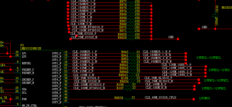

LMK03328: output LVPECL to LVDS receiver
Part Number: LMK03328
Hi Team,
My customer use LMK00328 as output 125Mhz LVPECEL type driver , and the receiver is LVDS type and has internal AC caps and 100ohm termination.
Do you have any recommend matching schematic design of LVPECEL to LVDS?  Since when using below schematic they found the output wave have trench.
Thanks.
