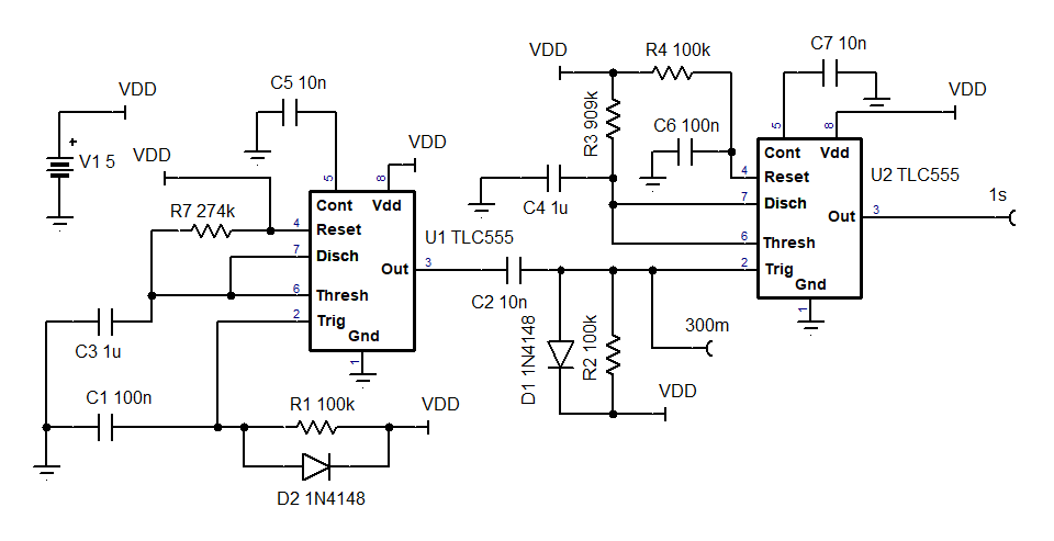

Hi all,
I want to make a one cycle pulse generator with an LM555 timer IC. The pulse timing after powering up the chip is: high (300ms) --> low (1s) --> high (continue until power off).
Help me make a circuit with the LM555 to meet the required pulse (given below).
                                                                                      300ms high                 1 second low                                           continuoe high till power off
As soon as the IC is powered up, the pulse should be started with the high edge.
