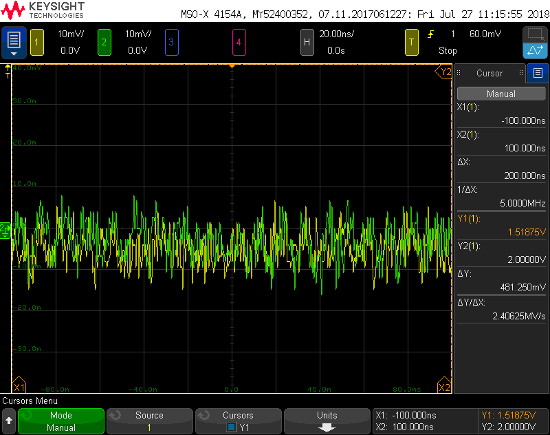

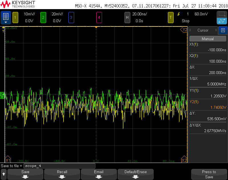

  • Sorry for the delay in responding. I was waiting for the board designer to make the measurements. The offset for both is small with around 10 mV PP noise. Have attached screen shots.
    The first is CMOS
    The second is Bipolar.
    The mystery may be solved. By switching clock sources, I found that LOS is only asserted for the selected clock so that when CLKin1 is selected manually (holdover not used) that LOS for CLKin0 (external clock not connected) isn't asserted. When I switched to CLKin0 then LOS was asserted. LOSx being viewed on STATUS_CLKinx outputs. My original description was incomplete but I expected the status to be active irrespective of which clock source was selected.
