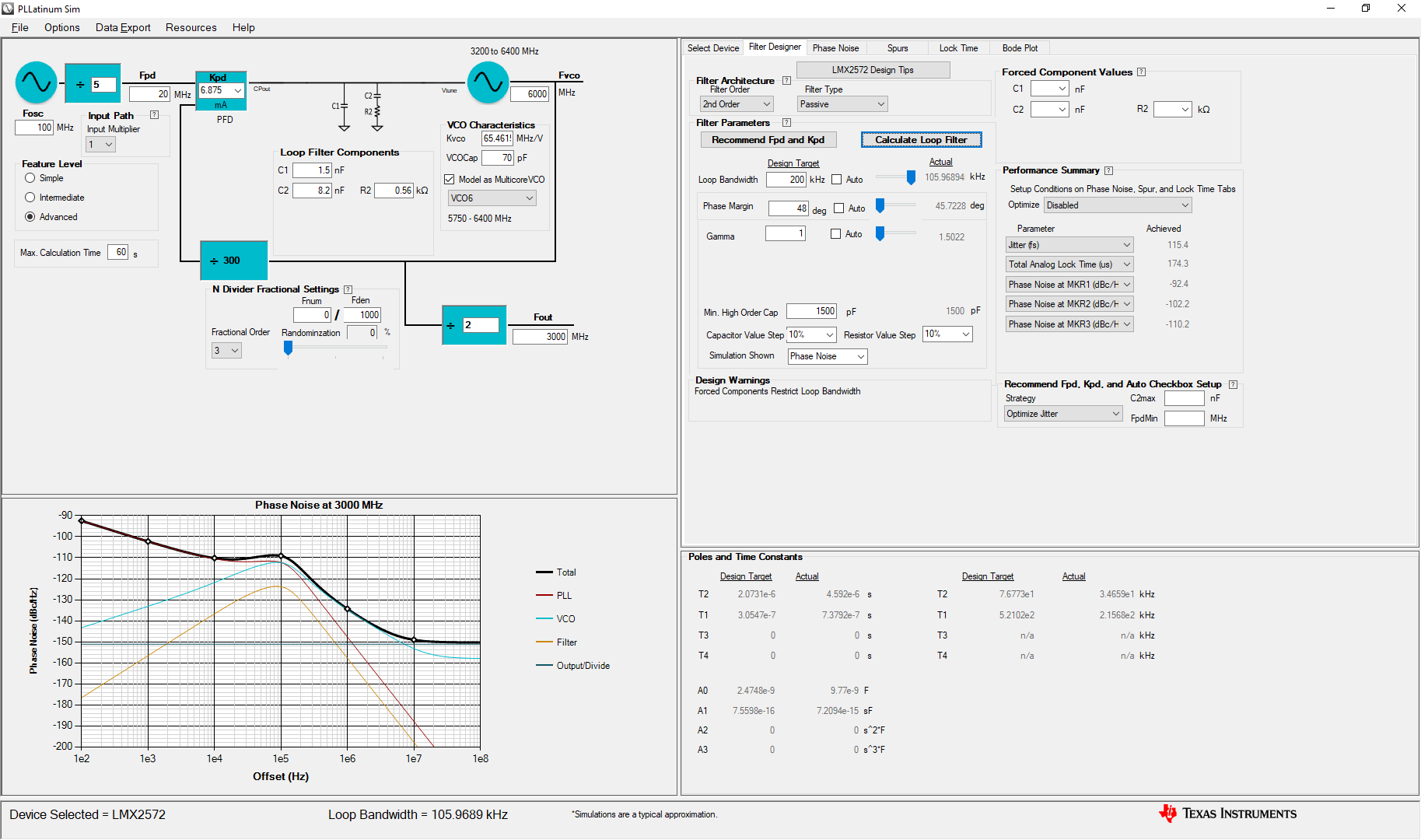

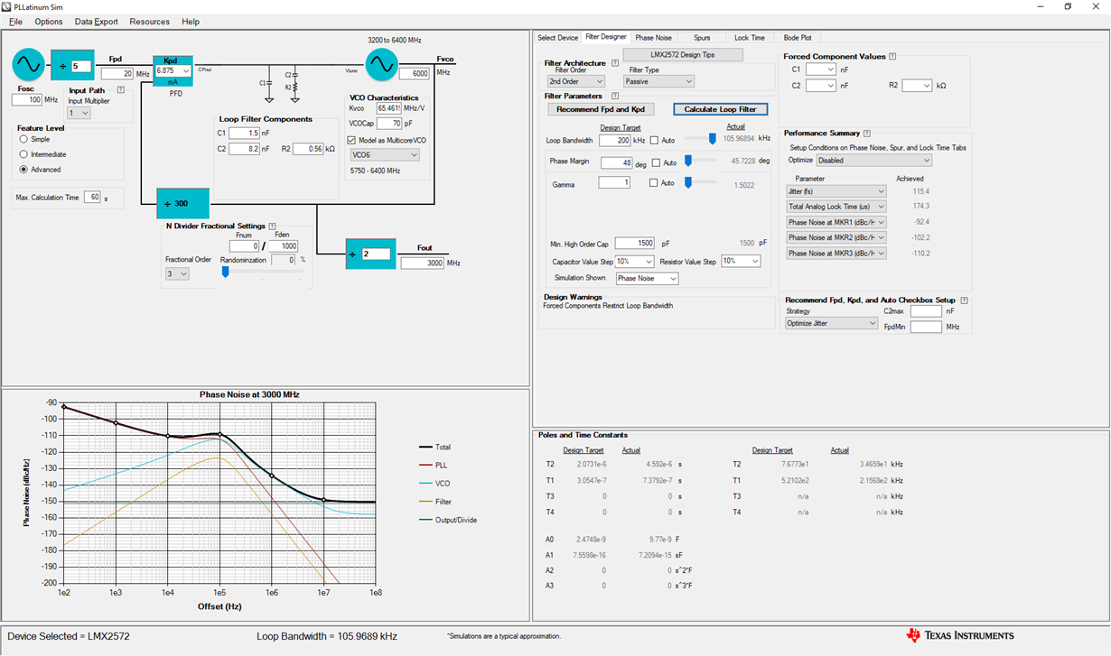

i would like to set the loop bandwidth to 200 kHz to increase the lock time. But PLLatinium limits the Bandwidth to 100kHz. I'm not sure why, maybe the input capacitance of the VCO is limiting? An active filter can remove this limit. I prefer a type b, 3.oder filter. Is it possible to invert the charge current on LMX2572?
Thanks Samuel
