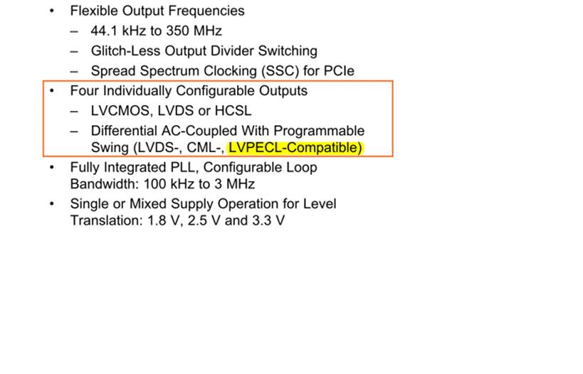

Hello
               Below is some question about CDCI6214.
  1. Does CDCI6214 support 156,25MHZ LVPECL format exactly? Has any jitter performance for 156,25MHZ LVPECL?
 2. Could internal EEPROM pre-burning parameters into it? Could TI can help pre-programming for customer before shipment to customer? Or this portion needs to programming parameters while get goods by customer selves.
BR
Patrick
  • Hi Patrick,
    Unlike LVDS, LVPECL does not have an industrial standard specification. As such, the definition of LVPECL may vary from vendor to vendor.
    Furthermore, when you AC-couple a clock signal, the name of the signal is not important anymore, thing that matter is the signal swing. A higher signal swing will in general provide higher slew rate, which will favor ADC.
    We can program the EEPROM in production before shipping to customers, please raise this request to our sales person.
