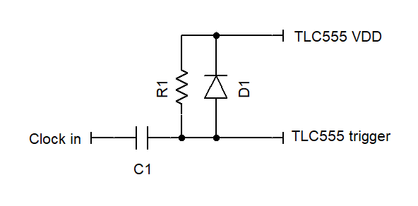

Hi, we've built a PWM circuit based on the example in the TLC555 data sheet (section 9.2.2), but can't get less than a 50% duty cycle.
We've a 500Hz square wave clock input to the Trigger, and the Threshold is fed from an RC network as you'd expect (3k resistor, 0.47uF capacitor).
We can vary the control voltage and get a change in the duty cycle, but the key fact is that when the clock is low, which causes the output to be set, the threshold input to reset the output does not take effect until the clock goes high, hence the minimum duty cycle is set by the 50% clock duty cycle.
This means that the graphs shown in figure 15 are not achievable in reality with the TLC555 if you're using a 50% clock, and I suspect that these were generated using a traditional 555 chip.
Can you confirm that this is a constraint when using the TLC555, and amend your data sheet to either have graphs that reflect the behaviour of the device, or at least a note detailing this fact more clearly, especially around the PWM example and the clock source.

  • Alex,
    The example waveform is a copy of the NE555 waveform. However the NE555 wouldn't produce less than 50% output with a 50% input waveform. So the waveform is also not correct for NE555. It seems to me that the waveform was hand drawn in 1973 although I can't prove it.
    All 555 timers are level triggered and also level threshold(ed). In other words, the trigger and threshold inputs are not edge triggered. The output positive duty cycle should be the greater of input negative duty cycle or the time to get capacitor voltage up to control voltage (divided by clock period).
    I am currently working on a new TLC555 data sheet and will add this to the list of data to re-take.
    This circuit is used to make the 555 timer act as if it was edge triggered.
