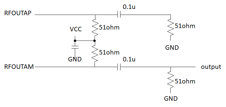

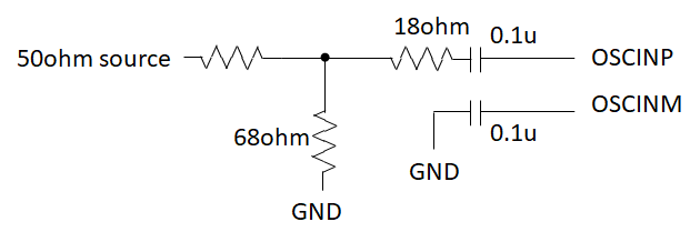

I would like to confirm if OSCin and RFout circuit below have any issue or not.
OSCin
RFout
