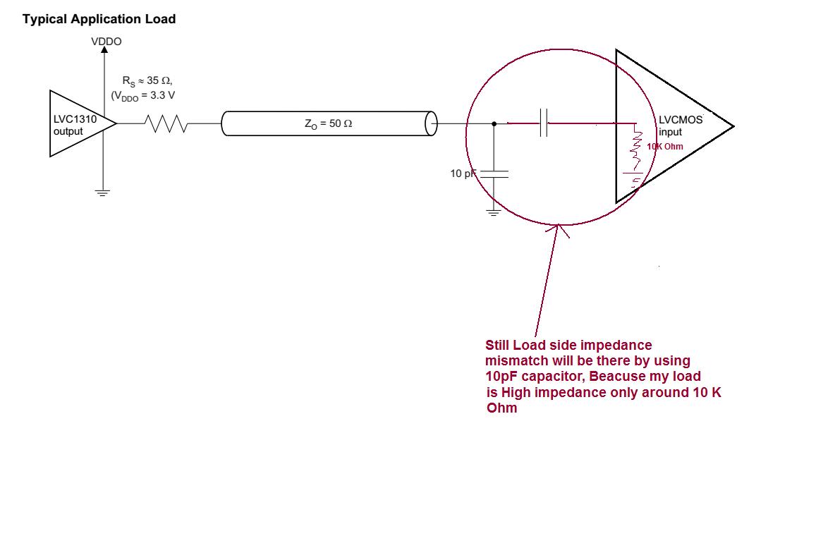

  •  Hi,
    I understood your solution will arrest only source side impedance mismatch not at load side. Please refer our typical circuit.
    Will it help adding 50Ohm series resistor with 500Ohms shunt resistor (potential divider) at load side instead of 10pF capacitor.
  • The series resistor (Rs) should provide source termination when the CDCLVC1310 LVCMOS output is driving a high-impedance load (e.g. LVCMOS input).  Rs should be sufficient for impedance matching the transmission line (50-ohm coax cable).
    Adding a 2nd termination at the load termination (Rt) may not needed and would form a double termination that would attenuate the driver's output voltage swing based on the voltage divide ratio of Rt / (Rs + Rt).
    If your LVCMOS input buffer has 10k pulldown, you should not use an AC coupling cap since the 10k would pull the AC coupled signal toward ground.  If you use VDDO of 1.8V for CDCLVC1310, then you can DC-couple the clock signal directly to your 1.8V LVCMOS input buffer.  Otherwise, if you need to AC-couple the signal (e.g. to block DC between the driver/receiver), you may need to add an external bias network (e.g. 1k pullup to 1.8V, 1k pulldown to GND) to set the common mode voltage of the AC-coupled signal to the LVCMOS input.
    Also, you should not intentionally place a 10 pF shunt cap.  It was only included to model potential parasitic cap in a typical application load.
