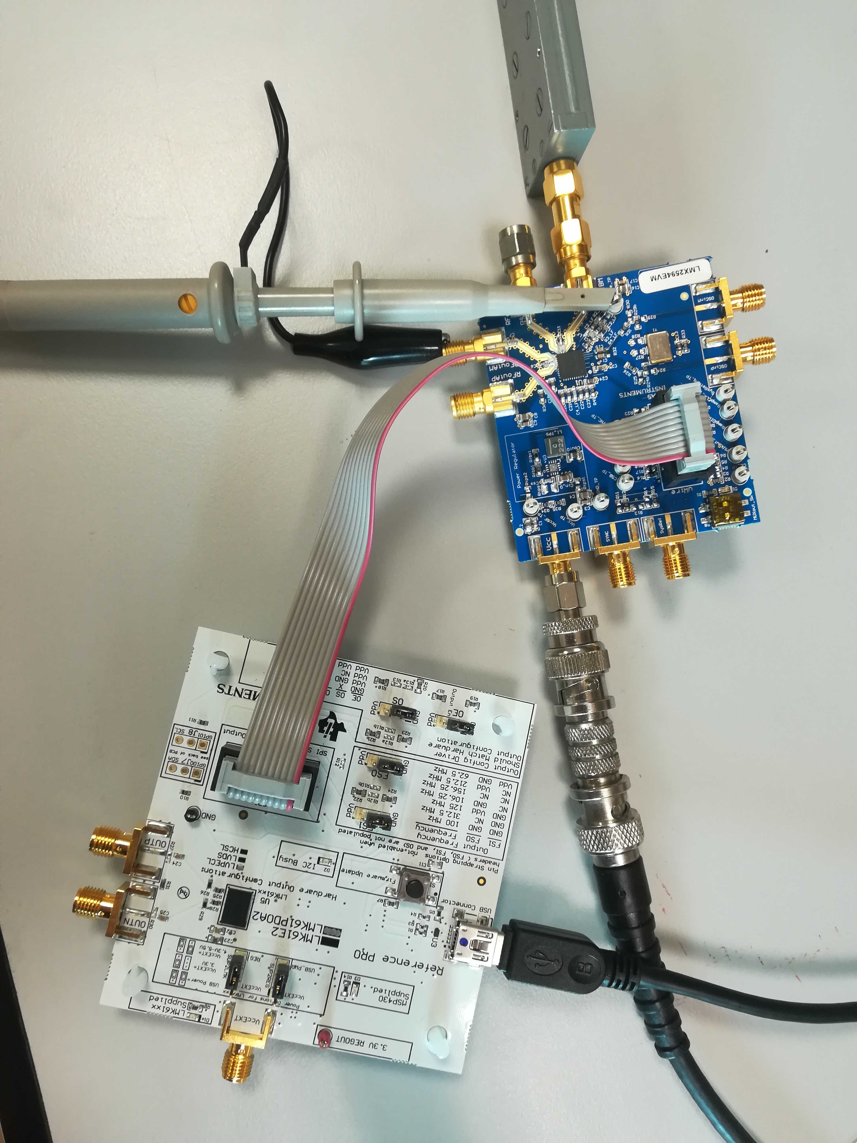

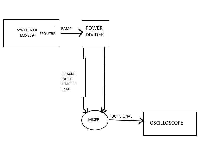

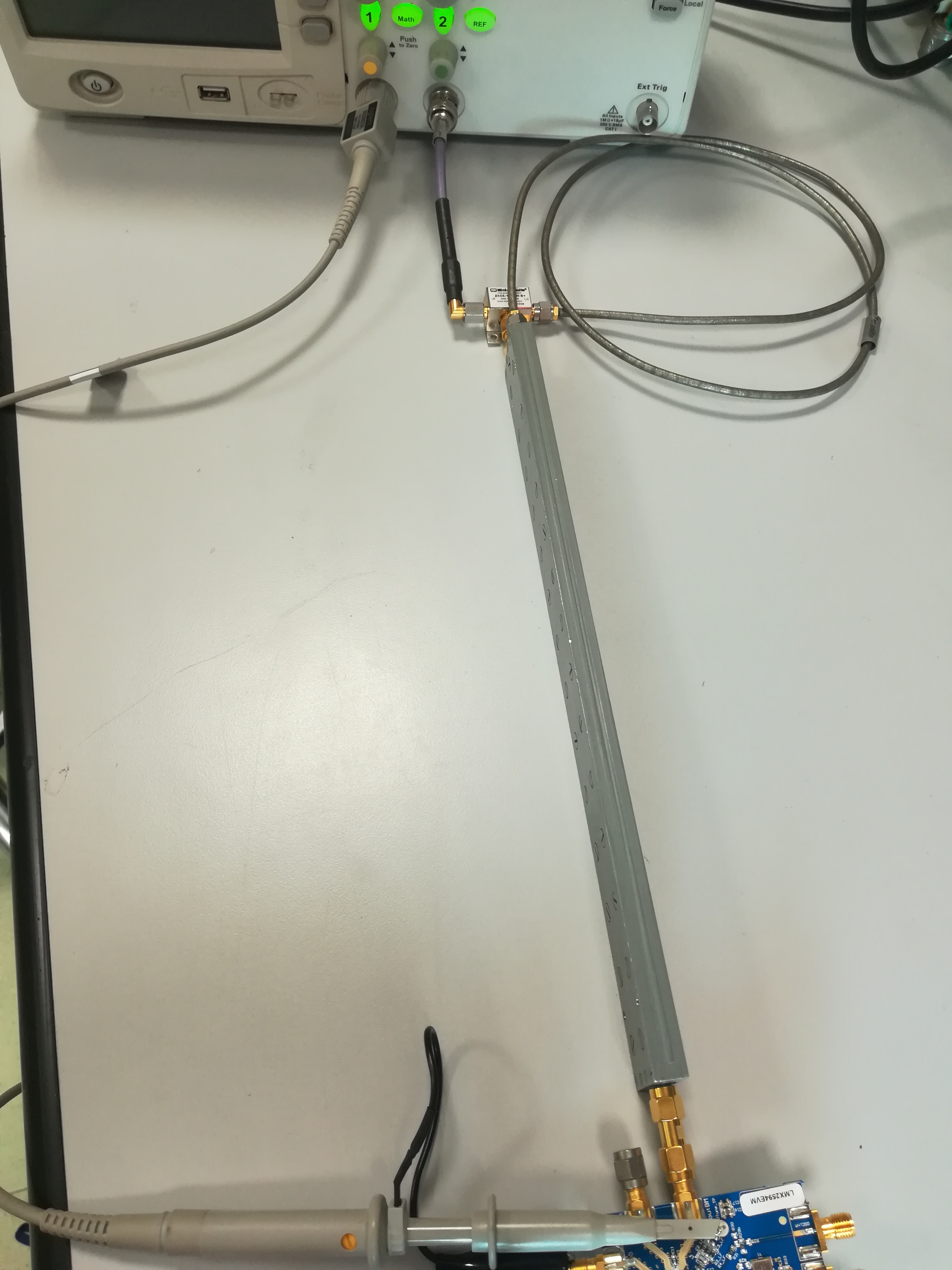

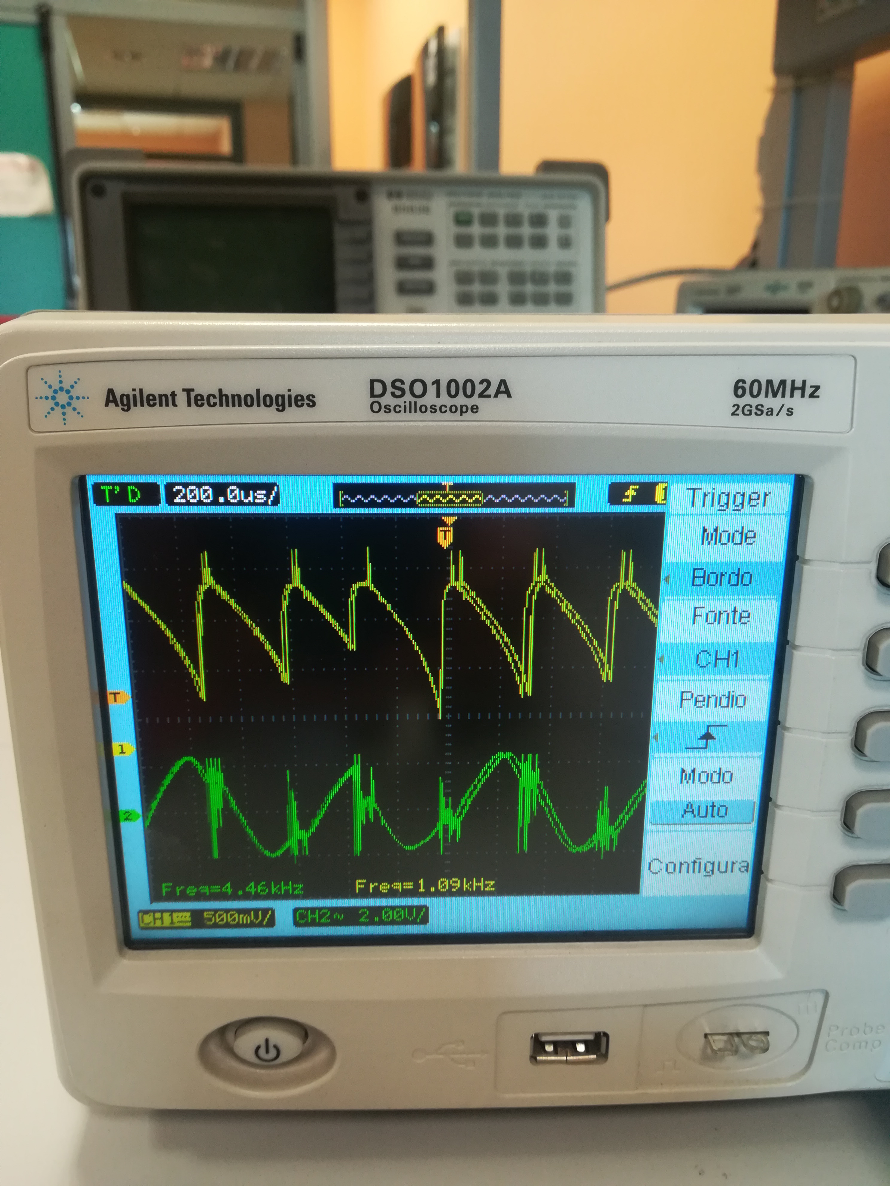

  • Thank you for your previous answers. I would like to ask you the reason why by changing the ramp parameters (low and high frequency limits / duration) the out signal is not changing.
    I aspect a variation about shape and frequency of out signal. I tested all the components (mixer,cable,power divider) and they are ok. My questions is: if i generate a ramp signal from 9187.5 to 9562.5 MHz with a duration 1000 us why i cannot see a changing in my out signal? I tested positively also the ramp signal in LMX2594 syntetizer ( pin Vtune_TP) as you can see in the attached files.
    Thank you for your cooperation.
  • Francesco,
    WIth your frequency switch, your ramp is not anywhere near to being calibration free. What this means is that the VCO has to calibrate many times during this ramp. This calibration takes a long time and the time that you are seeing is likely dominated by the calibration time of the VCO. The numbers in the TICSPro GUI are for the analog ramping portion; they do not account for the calibration time of the VCO.
    For experimental purposes, you might want to start with something calibration free. Try 9187.5 to 9197.5 MHz to see what the ramp looks like without the VCO calibration.
    Now above I was talking about ramp duration. The desired start and end frequencies should have an impact and the ramp limits should have an impact if they restrict the ramp.
    Dean
