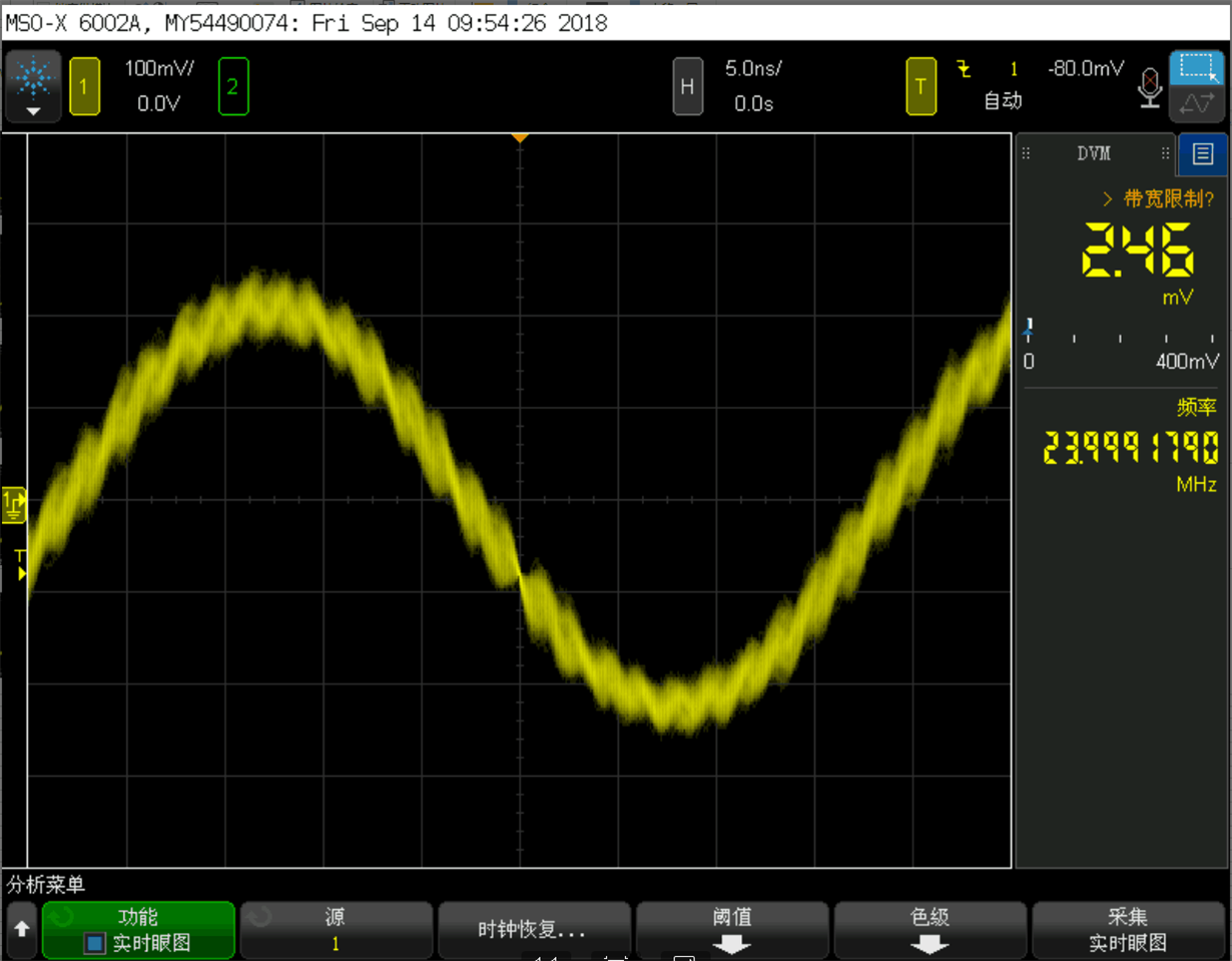

CDCE925: Something wrong when Xin linked to Passive crystal oscillator
Part Number: CDCE925
We connected Xin with 24MHZ passive crystal oscillator and found that the waveform of the crystal oscillator(Xin) was very jitter....  And i tried all the crystal load configurations without improvement.。
Thx  help
  • Does your crystal meet the recommended crystal characteristics in the datasheet?
    Is the issue repeatable if you swap crystals or try a different board?
    Did you make sure there is no excess parasitic capacitance externally (use short traces, no large external trim caps)?
    Alan
