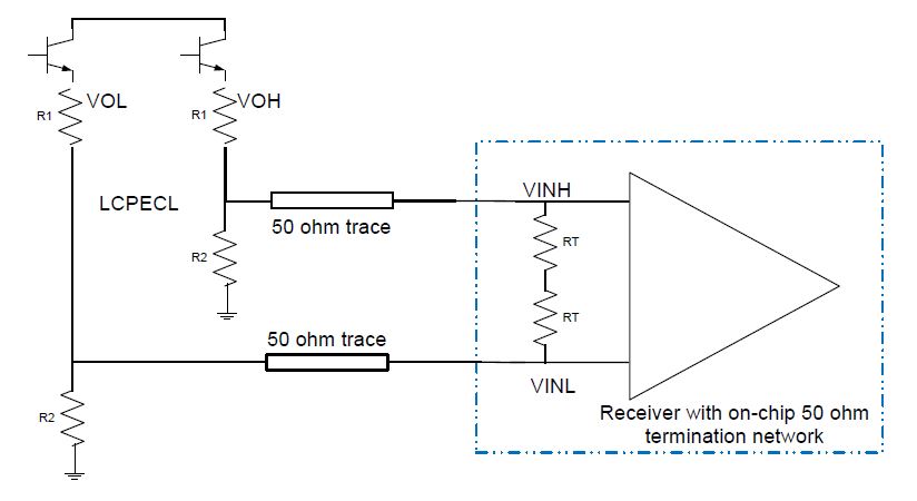

    Yes. The single pulse on SYSREF could work. LMK04828 datasheet section "9.3.2.1.1 Setup of SYSREF Example" shows an example for 2 pulses SYSREF. It need DC coupling from LMK04828 to ADC. LMK04828's LVDS output type can match most of ADCs/DACs/FPGAs.
    LCPECL type is another option when LVDS can's match receiver spec. When we tune serial resistor R1 and bias resistor R2 for LCPECL, we can achieve different Vcm and Vod signal (|Voh-Vol|, single line swing) . For example, refer to below schematic,  when we select R2 = 162.5 Ohm, R1 = 57.4 Ohm, Rt = 50 Ohm,  we can get  VINH = 1.05V, VINL=0.65V, Vcm 0.85V.
