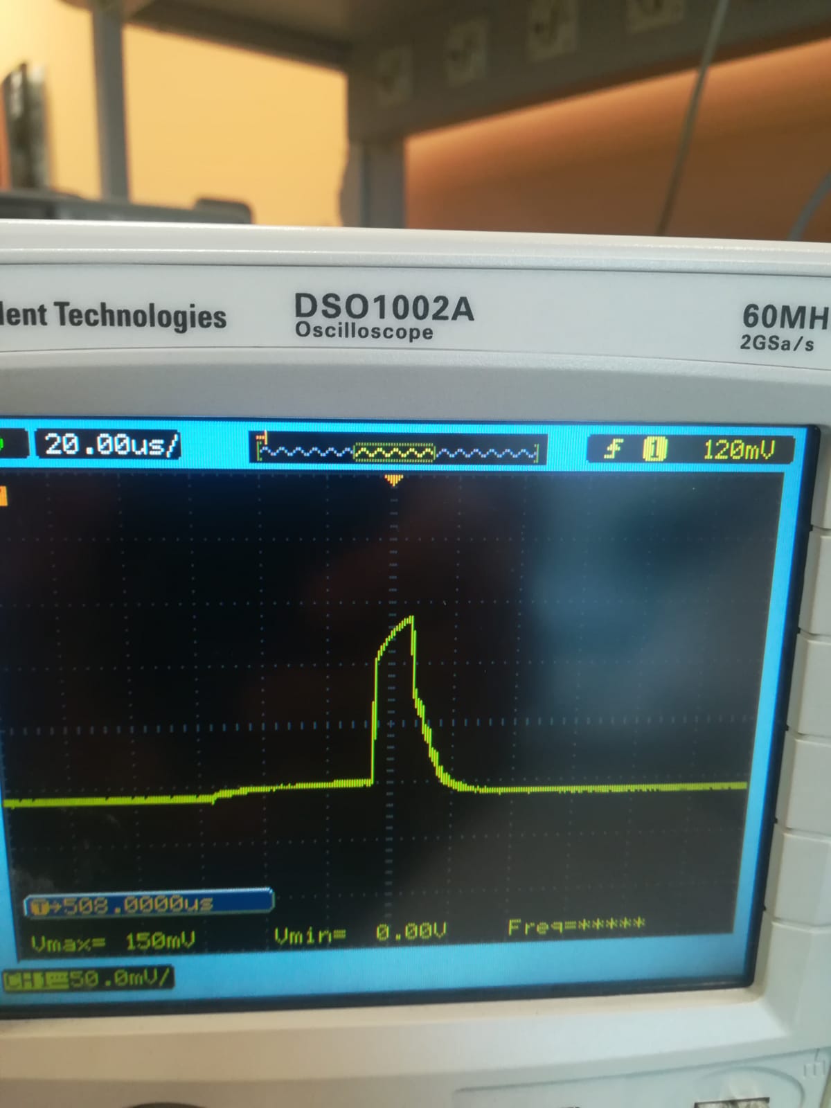

  • hi noel,
     the problem is that nothing works in the circuit anymore. It was working when suddenly it stopped working.
    When it still worked, under normal conditions ('device on' and 'output enabled') on the Vtune_TP pin there was an offset while when the "ramp" function was activated there was a ramp as shown in the figure. Now, the only thing I can notice is the presence of an offset on the Vtune_TP pin that grows in step with the power supply but nothing happens on the RFOUTa and RFOUTb outputs. In this last case the current absorption is about 200 mA. In normal conditions, in the case of an output signal at 9000 MHz, the absorption was equal to 400 mA, whereas in the presence of the ramp signal it was 430 mA. I tried to do all the tests that Dean suggested to me, but I can not solve the problem anyway.
