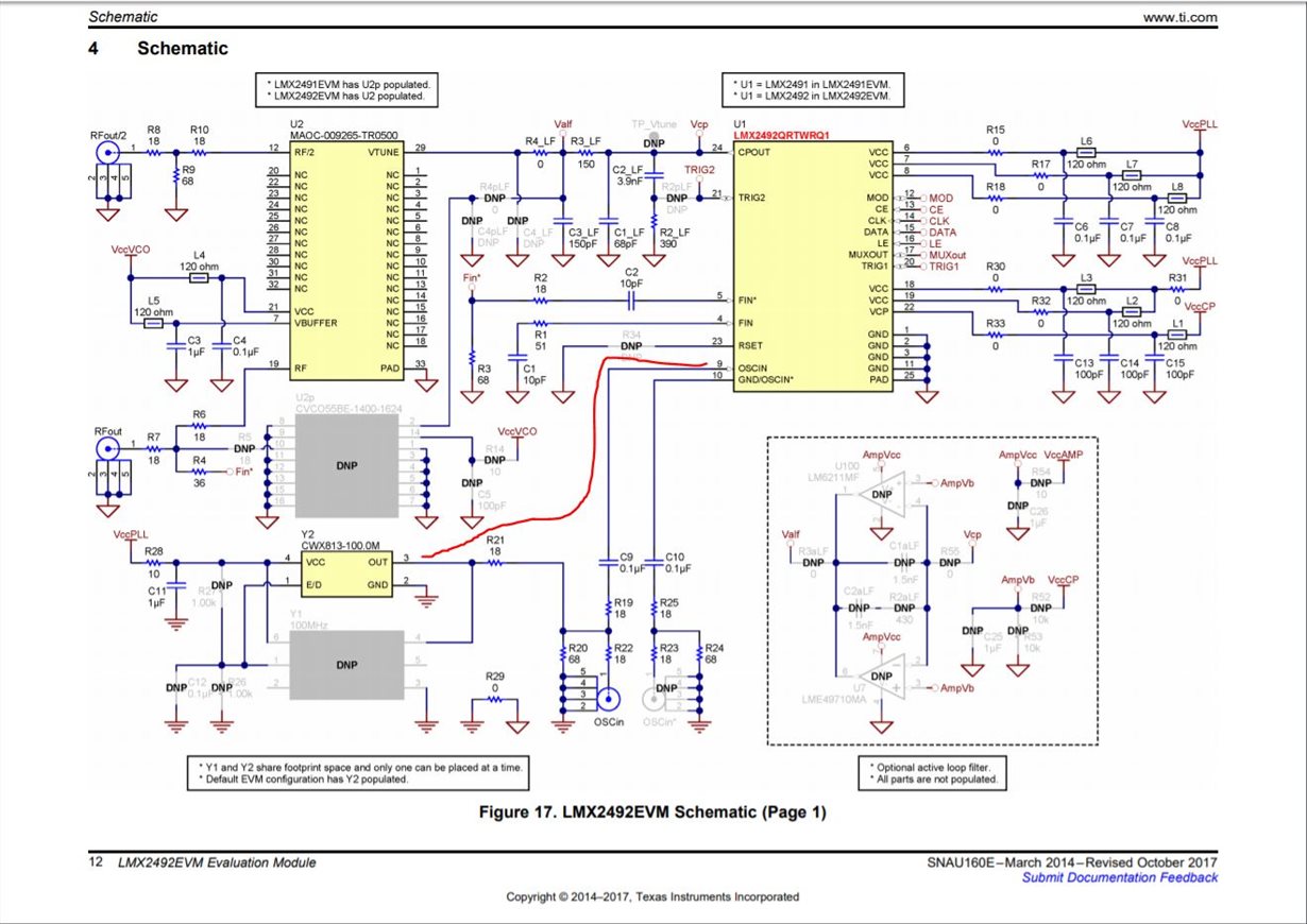

  • Dean,
    Based on the manual, the default setup is having XO connected to the PLL. I took two screenshots from the TI manual of LMX2492EVM, and one of them shows the experiment we are doing now (Chapter 2 setup) and the other one shows the schematic of the evaluation board. I use red line to indicate the path from XO output to PLL OSCin pin. From the schematic, they are connected without any modification.
    Again, we did nothing to the board, except powering it up (with required 5V) and measuring the output with oscilloscope.
    Shuo
  • Shou,
    There are two things that come to mind:
    1. Input reference not connected
    I know the instructions say that it is. However, we shipped a large number of EVMs that had the XO disconnected. Note in the revision history on page 23 that it says that between revision D and E that it was "changed to include the on-board XO". So in summary, would be good to make sure that your board is actually assembled R28, R21, R19, and C9 placed. We should be sure that you don't have an older revision of the board.
    2. Device is powered down (CE pin - pin 13 low?)
    Realize that the VCO draws a large amount of current and will still have an output at 4.5 GHz when the PLL is powered down. To ensure the device is powered up, you can change the POWERDOWN bit on the User Controls in TICSPro and it should change the current about 60 mA. Also, when powered up, the OSCin pin should have a DC bias of about 1.5 V and should have a DC bias of about 0V when powered down. Fin pin should have 1.6V bias powered up and 0V powered down. I say this because I see that the CE pin (pin 13) is on the schematic) and hooked to the header (pin 5), yet I see no way in TICSPro to pull this pin high. I also see no pull-up resistor on the board for this.
    Dean
