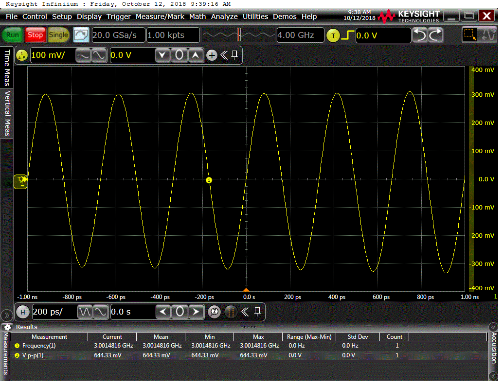

Now we have a problem about LMX2592 using:
LMX2592 is used to generate two 3GHz sampling clocks connected to two ADC12DJ3200s, which are designed as below:
Where, the LMX2592 outputs are named as ADC_LMX2592_REFOUTAP/M and ADC_LMX2592_REFOUTBP/M. Behind the AC-coupling capacitors the two differential-ended clocks are connected to ADC12DJ3200s.
The measured Vpp of LMX2592 output is about 660mV using KEYSIGHT DSO90404A and the attached differential strobe, with the LMX2592 OUTA_POW register(REG46[13:8]) set to 0(decimal). The output the result is as below:
The 660mVpp (approximately -3.46dBm on 100ohm characteristic impedance differential lines) result is far smaller than the nominal rating in the datasheet: 8dBm@3GHz output frequency (Page7: Chapter 6.5 Electrical Characteristics). So, we set the register to a larger value, which was meant to make the output power larger, but the output power didnot increase as the datasheet says "increase power from 0 to 31" in the page 27:"Table41.R46 Register Field Descriptions".
For example: when set to 8(decimal): about 70mVpp
When set to 31(decimal): about 40mVpp
Even when set to 63(decimal): about 30mVpp
Result from the screenshots above, we can see the output power didnot increase with the register value got larger; Inversely the output power seemed to be decreasing with the register increasing.
So, I wanna know where maybe the problem exists, or what is the correct method to increase the output power of LMX2592.
Looking forward to your answer, thanks a lot~~~!
