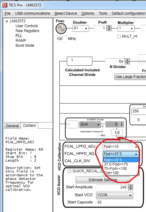

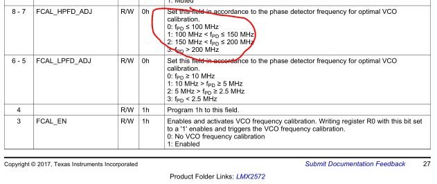

In Datasheet:
In TICS:
What to believe?
Dean,
our observations show that the chip works correctly when FCAL_HPFD_ADJ value set in accordance with the TICS.
We also noticed a discrepancy of "Start VCO" parameter in TICS and Datasheet.
