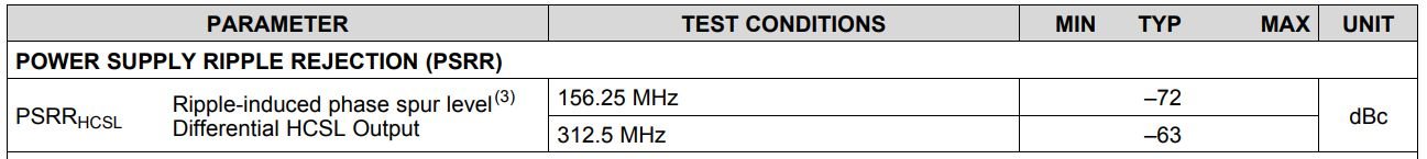

LMK00334: Ripple Frequency condition of PSRRHCSL spec
Part Number: LMK00334
Now I'm referring the PSRRHCSL spec in electrical characteristics but there is no information about Ripple Frequency condition. I also refer the Fig.7 and Fig.8 that is PSRR vs. Ripple Frequency but then these graph show lower values than electrical characteristics.
