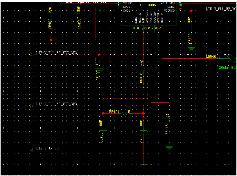

Hi team,
 1. If customer only use one side of the output pin, as single ended output, do they still need to add pull up resistor and ac cap and also add a load resistor ?
2. If the below design is good?
3. For the disabled output channel like outputB+/- in below schematic, can they left pins floating?
