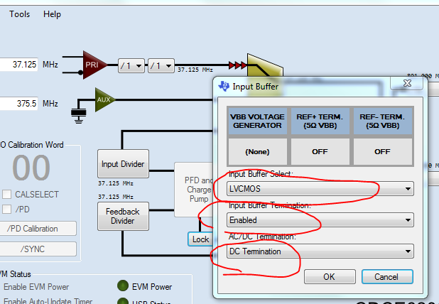

hi Sridhar,
Thanks. My question is for the application, whether we need buffer or not, and we need to select DC or Ac termination. Thanks.
Hi Frank,
There is no need for an additional buffer. You can select DC termination if your input is LVCMOS. Also, select the appropriate register setting for reference termination based on Table 17 in the datasheet
