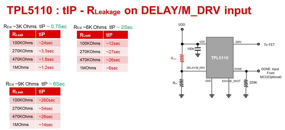

I want to use a P-channel mosfet for the manual reset of TPL5010. According to the datasheet this pin is sensitive to capacitance as it can affect the time setting accuracy. Could anyone tell me the max allowed capacitance ?
Thanks.
